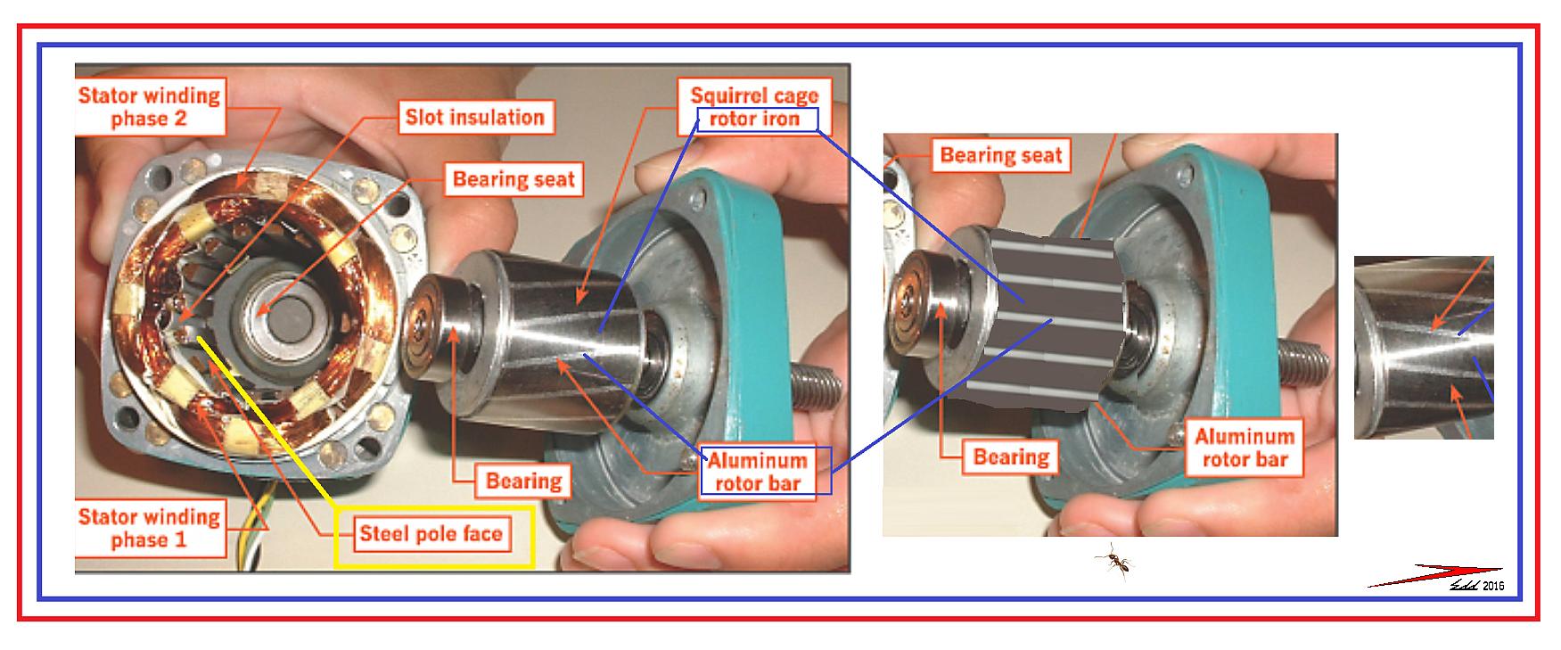

Sir Pharaday . . . . . . .
On that type of AC synchronous motor that you are working with , and its indeterminate start up direction, look at the center duplicated pic to the right and note the motor rotors 16 separated iron pole pieces and companion alum-i-nin- ni -yum- yum divider bars are being aligned PARALLEL to the plane of the motor shaft. Referencing with the BLUE line markup.
Over on the motor stator winding there are 16 pole pieces, one of which is referenced by the YELLOW line markup.
When the motor comes to stop, it will be randomly leaving the stator and rotor iron pole pieces being a little bit CLOSER to one another in that resting position. On power up the initial power surge will favor that closeness and that is the direction that the motor will initially get its magnetic kick to start up and rapidly build up its running speed in THAT direction .
Looking at the initial main picture at the left, note that the rotor there is designed with a twist /slope made to the construction of the iron pole pieces and the aluminum bars in rereference to the motor shaft axis..
Additionally the positioning of the rotor inside of the unit is such that the rotor is not exactly centered . . .front to back . . . on the
stators pole pieces. That dissolution of the 50/50 positional probability, along with the magnetic slope of the rotors pole pieces, assures that the initial rotational start of the rotor is made in one select direction.
If the motors directional need was for its running in the opposite direction, the iron pole pieces and the aluminum bars in reference to the motor shaft axis, will be sloping in the opposite direction. See that rough depiction . . . . at far right inset.
Sooooooooo . . . . in applications where the start and running direction of an synchronous, motor is critical . . . that's how its done on . . .appliances, fans and I particularly remember one case . . . . .of a phonograph motor.

For starters the Induction motor in #13 does not have rotor poles until the current is induced (Induction motor!) in the shorted turns created either by aluminum or copper bars, without these the motor will not rotate and resemble a large choke or inductance to the applied AC.
The skewed lamination's in the rotor is for smoothness of operation only.
This method is used in high quality DC servo motors to prevent cogging at low rpm.
The randomness of the start direction of a synchronous motor in the OP type is normal and if it suddenly develops a random start direction it usually indicates the means of initial start direction has become compromised.
