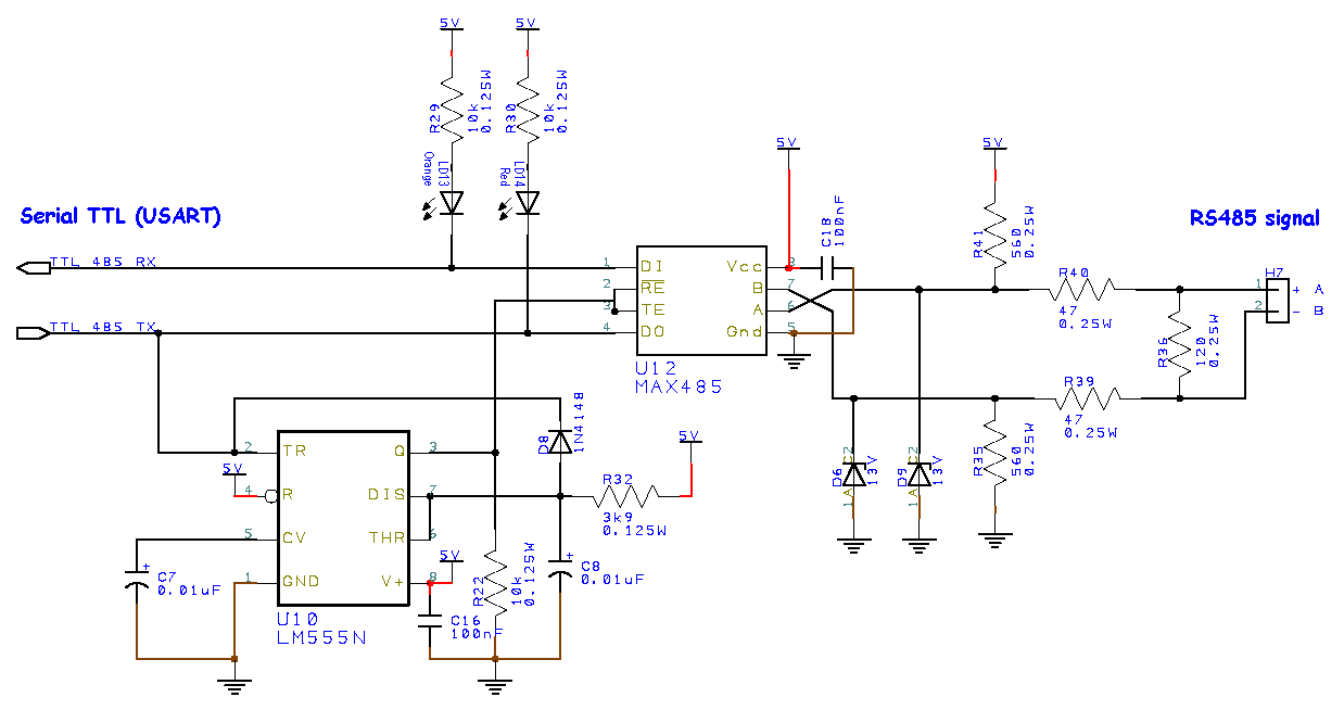

now another request plz can someone share a circuit /schematic for rs485 using max485 keeping in mind distances upto 70 meters
should this circuit work if r39,r36 & r40 are not used? also the zener and the led section also be removed
