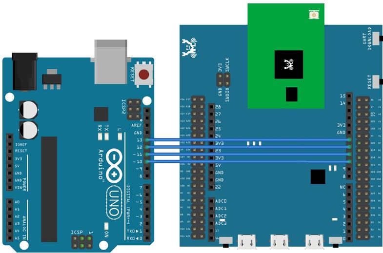

SPI is a fast and robust communication protocol that are commonly found on many microcontrollers and is often used to retrieve sensor data or output image signal to a display. RTL8722DM supports SPI in both master and slave mode. Here we are going to see an example demonstrating how to receive data in slave mode on MicroPython on the RTL8722DM board.
Before connection, make sure to upload the following code to your Arduino UNO.
#include "SPI.h"
#define SS 10
void setup (void) {
Serial.begin(115200); //set baud rate to 115200 for usart
digitalWrite(SS, HIGH); // disable Slave Select
SPI.begin ();
void loop (void) {
char c;
digitalWrite(SS, LOW); // enable Slave Select
// send test string
for (const char * p = "Hello, world!\r" ; c = *p; p++) {
SPI.transfer(c);
Serial.print(c);
Serial.println();
delay(2000);
Connection is shown as follows, here we are using RTTL8722 as SPI slave, and Arduino UNO as SPI master,
Then copy and paste the following code into REPL under paste mode to see their effects.
Code:
from machine import SPI
s1= SPI(0 , mode = SPI.SLAVE)
for i in range(14):
chr(s1.read())
MarkCrabs1
