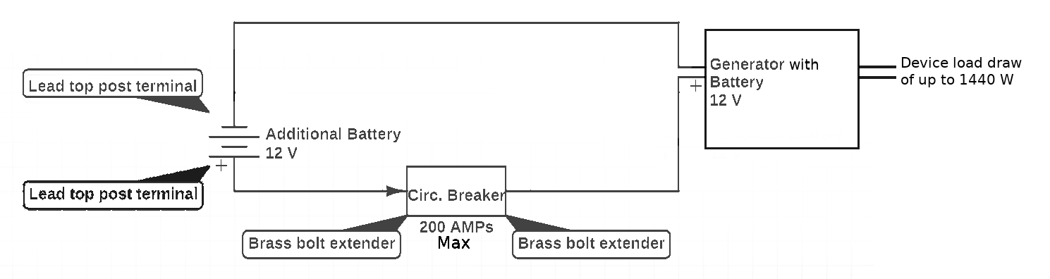

I have an all-electric generator (1440W continuous) and I am hooking up an additional 12V battery to it in a daisy-chain way. I got top post terminal kits made of lead (link) and am using brass battery bolt extenders on a circuit breaker (link). Given up to about 120 Amps may be flowing through the cables connecting the 12V battery, are lead and brass components going to be up to the job in terms of safety? I read those metals have lower electrical conductivity than some others (link).

I think you really need to provide a circuit diagram of what you have to avoid any confusion.
The battery post terminals might be ok as the battery terminal itself is lead, but where it might let you down is how you connect to that particular terminal.
As it stands it looks like just the one bolt (maybe 5/16") and the contact area for any lug is not that great.
No details on the terminal itself as far as rating is concerned.
Your other link to other equipment is not working so who knows.

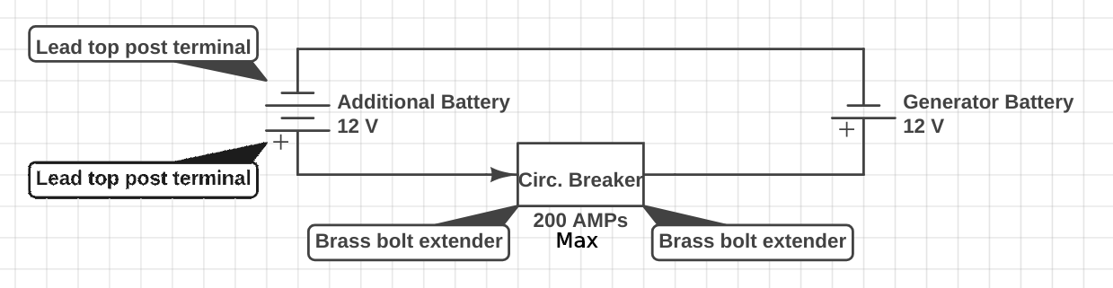

Thanks for the feedback @Bluejets. Here is my attempt at a circuit diagram:

For the convenience of others, it is best to post any photos here rather than in links where one has to search other sites.
Your circuit diagram doesn't make sense as it has two battery supplies with their negatives tied together and a circuit breaker across the two positives which would only serve to join the two supplies together without any load.
Does one battery represent your generator...??

@Bluejets thanks for the follow-up.
The part of the circuit diagram that is labeled “generator battery” is a generator that has a battery in it. The generator will output power to devices using the two batteries as power sources.
The purpose of connecting the two batteries together is to increase the battery capacity of the generator.
The negative terminal of the battery connecting to the negative of the generator is the correct connection arrangement in my understanding.
The circuit breaker is included to protect the additional battery if a power overload were to occur.
