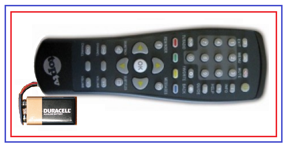

At this point in time and not knowing your brand of unit, BUT knowing that it is utilizing a 9 V battery for power.
Lets find the most important parameters associated with the unit, since verification that batteries are not being the problem.
As per the mock up illustration below most 9 v powered inits have a bit of a pigtail on the battery.
Lets take our DC metering and unplug half of the battery and swing its contact 90 degrees . That will be leaving you easy access
to place one meter probe on each terminal, one on the battery proper and the other one on the 9V plug connectors now free terminal.
That will open its power input circuitry to permit monitoring THE current drain of the unit .
Don't worry about probe polarity, as it will sort itself out on the meters display readout.
Place metering in DC CURRENT MODE. If auto ranging instrumentation, let it seek out for you , if being manual, initially shoot on up
to a very safe 100 ma and work down as needed.
Test a number and you will probably just get a fast single current blip.
Test a vol up or volume down . . . . . ch up or ch down and the unit willl be pulling current as long as the button(s) is/are held down.
Figure your worst cases and log down.
But NOW ! the real thing that we are wanting to know is, with no button activity, what is the quiescent current drain that the unit is taking from the battery for 24 hours a day.?
Feed back those magical numbers to us for evaluation.
Thasssit . . . . . .
Techno Illustration . . . . .
(In not knowing if you might have a "TOP" brand, or yours might just be an el cheapo "Bottom Feeder")
73's de Edd
