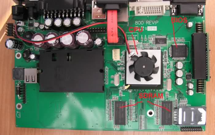

From time to time I must repair an equipment that has its own BIOS, CPU and SDRAM
This SDRAM has 256MB together and consists of 4 SDRAM modules(IC).
Sometimes equipment does not work.Then there are several possibilities for that.
Faulty CPU or BIOS or SDRAM.
Is there a method how I can find out that SDRAM is faulty? If so which module of those 4 SDRAM modules might be faulty?
Each SDRAM module has 66-pin Plastic TSOP(II) and is soldered on PCB.
Thank you for help

But how can I find out a way to test the SDRAM. That is my question.
Imagine a computer like device.You do not want to desolder SDRAM, you do not have schematic of the mainboard.You can find out( by measuring) wires( path) from CPU to BIOS and from CPU to SDRAM.
Or how at least find out that CPU sends any address signals to SDRAM, so that I will know at least path between CPU and SDRAM is OK.It would be the first step.

Olivier ,
thanks for the reply.YES, you are correct.Bios doesn't seem to loop.And that is also probably my problem.
I can measure clock generated by CPU .Always .It is always available, eventhough device does NOT start.( also for the reason that SDRAM is faulty or path from CPU is damaged). But I can not measure any other signals with SDRAM, if the device does NOT start.The reason will be probably that BIOS doesn't loop.
But what solution would suggest then?
Thank you for help

Jane
Dec 27, 2011
8
Dec 27, 2011
8
Olivier, thanks for the reply.
And here are answers
-It's the BIOS socketed?
No, but it is not a problem to desolder BIOS chip and solder a new one
-It's the CPU socketed?
No, but it is not a big problem to desolder it either
What's the used processor?
Broadcom BCM7401
-Is the board have an extension bus?
I do not think so, but not sure. How can I identify such extension bus?
-What's making this board so specific?
We repair these products
-is the board manufacturer still is business?
Yes and there are also more companies that make copies
-Can you please post board pictures?
Here it is
2 more SDRAM modules are from the oposite site of the mainboard.CPU is under the fan
-Do you fell that, with a modified BIOS, the board can run with 1 RAM chip only
I do not thinks
-What's the cost of your labor+part comparing to let a dedicated external company rework all the board (by batch maybe)?
It would better for us to repair themselves
-Can you expect a break even for a logic analyzer buying or renting?
Hard to say
-is the board part of a large expensive system or is almost the system by itself?
No
Thanks for your help
