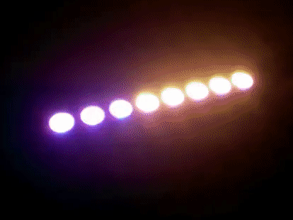

I am using an ATTiny85 to control a WS2812B strip of maybe 50 beads, **which works fine**. The problem comes when I added a second 'strip' of 1 pixel to act as a fancy indicator light instead of an LED. Regardless of whether I enable the code for the second strip, the code will not run (first thing it would normally do is turn on an LED, which is how I know) if the DataIn lead of the 2nd strip is connected. However, if I connect the second strip DataIn after the code starts, everything works.
I suspect there is something about the load from the two strips that is causing issues at startup. I've added resistors from 470 to 10k to the data lines with no improvement. I also put a decoupling capacitor on the MCU VCC/GND. The strips already seem to have capacitors.
Since this is a startup issue, I should mention that I am using ATTinyCore with Micronucleus, and the 2nd dataline is going to PB3. D+/D- are isolated by a jumper pin block when running.
Any feedback or ideas are welcome.

My bad. I'm now strongly suspecting the bootloader, which also seems to take a variable amount of time to exit. So, now I have to figure out how to reconfigure, etc.

First thing we need is a circuit diagram and the code. We have no idea how you connected the parts and what your code does / is supposed to do.

Have you tried a different piece of LED strip? Could be the 'add-on' section is faulty.

Yep, that did it. I reconfigured the bootloader to only run on reset. It appears it really doesn't like running with D+/D- not connected to a USB, or to other stuff.
For reference: to upload, I cut the USB and jumper the D-/D+ to the MCU. Then invoke Upload from the IDE; when it says 'connect', I turn on the USB port and hit reset on the MCU. When the upload finishes, I cut the USB again and jumper the PB3/PB4 back to their running configuration. Turn on the USB power, and the code runs immediately. I will investigate for final version is using a data cable for flashing, and a charging cable for running.
