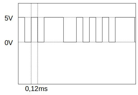

OK.
I try to test it with a minimum software. So I initialize my modules and just after write :
Code:
while (1) {
    CLRWDT();
    UART_Write(0b10101010);
My UART_Write function is the same as in my first message.
I've mesured by my oscillo the signal generated. Unfortunately, I can't export it to my computer and I've no camera to take a snapshot. So I've to draw the signal generated manually… :confused:
Here is :
As signal is idle high, I think that a 0V is a bit '1' and a 5V a bit '0'.
So, I can read :
  • a '1' start bit
  • my message (0b10101010)
  • a '0' stop bit
  • a final '0' bit which maybe correspond to the moment of the CLRWDT() instruction.
    [EDIT]No, after deactivating the WatchDog Timer and removing the CLRWDT() instruction, result is the same[/EDIT]
The 0/5V and the 0.12ms time are mesured by the oscilloscope. 0.12ms seems to bee a bit long.
After trying to do the same, with external 16MHz quartz (OSCCON = 0x70) instead of internal HFINTOSC set to 16MHz too (OSCCON=0x72), signal is the same but time mesured between 2 edges is 32µs...
Why ? I don't understand...

32 us for a bit is exactly what you should expect for 31250 baud.
120us (0.12ms) is almost exactly 4 times longer.
Does it work with the crystal instead of the internal oscillator?

OK !!!:D
I found my f...ing mistake !
The finality of my µC is merge different MIDI signals.
For this, it read from a SD card and can receive signal by other ways.
Each port save its data in a separated large buffer.
My main loop run through each buffer, one by one and when a complete MIDI message is found, send it via Usart connexion.
My fault code, when sending the message :
Code:
for (i = 0; i < iRxByteCount; i++) UART_Write(arrRxNote[iRxByteCount]);
... :oops:
It sent 3 times the last read byte...
Obviously, the right code was :
Code:
for (i = 0; i < iRxByteCount; i++) UART_Write(arrRxNote[i]);

Yes I still have this problem. For saving power, I switch on internal oscillator whenever possible.
Normally, it's always working on the crystal when sending data. But in case of failure of the crysrtal, fail-safe PIC's internal module switch to internal oscillator.
So I'm going to try now to send my signal with internal oscillator. I don't know why it appears to be 4 times slower than crystal.
EDIT : it seems to work fine now, even working on internal oscillator... I don't what happened just before...
It seems that the problem appears when switching from one oscillator to the other one. I don't understand why, cause they work at the same speed.
