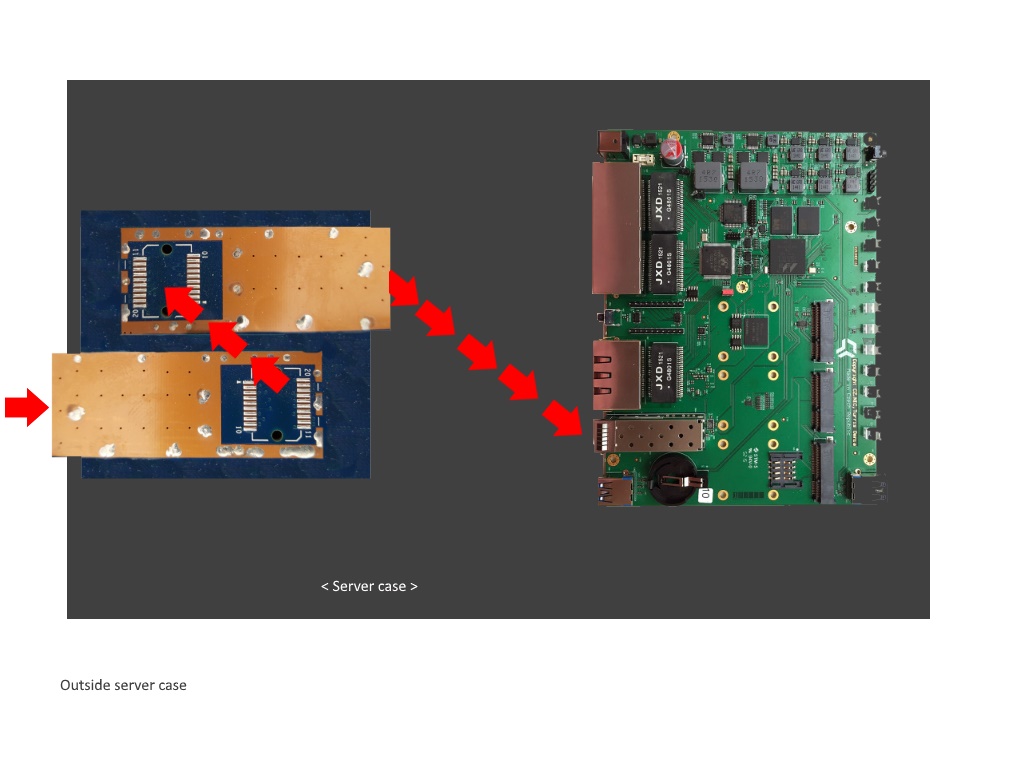

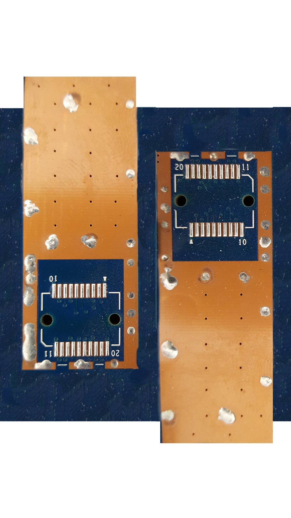

Hey all I am just wondering before I do this if its possible to connect 2 SFP sockets to each other in order to bring in the fiber connection and then take it back out the same way?
So in the image above, Pin 1 would hook up to Pin 1 on the second SFP socket. Pin 2 would hook up to Pin 2 on the second SFP socket, etc etc...
I'm doing this so that I can bring in the SFP connection into a server case and then once inside the server case I need to hook it up to a motherboard inside there that has the SFP connection.

Are you attempting to tap into it or simply couple two strands together?
You know there are passive components that do this right?
There has to be a reason you chose two SFP devices instead of a simple coupler.
You should also review the pinout... https://en.wikipedia.org/wiki/Small_form-factor_pluggable_transceiver#Signals
You can't simply connect pins 1-1, 2-2, etc. This is true with *many* devices. The pins are not bi-directional. At the very least, you may need to swap the Rx, and Tx pins but even then, you may not get what you want to accomplish

To better illustrate what I am trying to accomplish:
Still looks to me like you only need a coupler.
Fiber arrives at the outside of the case, gets plugged into the exposed portion of a 'passive' coupler.
Internally, the hidden side of the coupler is connected to a smaller strand of fiber that goes to your board.

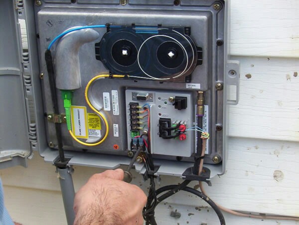

it's for my ftth Internet connection so I really don't know what type of fiber connector they use...

this is what the ONT fiber hook up looks like that I am wanting to use (green connector).
It looks like SC to me... but I mainly work with LC.
Next question I have is... why tap into it there?
Does the SFP module you currently have use the same connector? If not, you will need a small patch cord with a different connector on each end.
