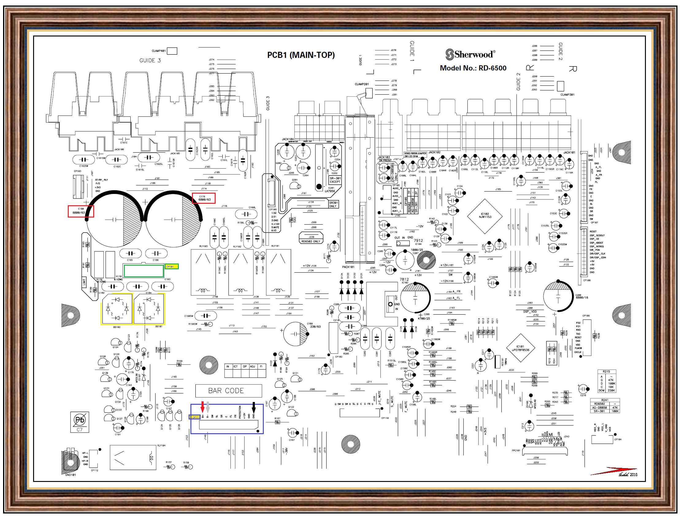

Herewith, one mark up on the initial relevant locations on the top of that units mainboard.
When you pulled the 3 pin connector (You can see it now as GREEN CP101) you removed the main POWER AC voltage from the units transformer to the MAIN POWER supply of the unit.
This supply feeds the REALLY POWER hungry portion of the receiver . . .the audio output section.
The rest of the set is receiving its power from smaller sub- power supplys.
Sequenced Power Supply and Loads Troubleshooting :
This is to be done with no AC power applied . . . just relying on an ohmming out of areas.
Initially reinstall your CP101 plug that you removed earlier.
Take ohmmeter in hand, set to lowest ohms scale and move to connector BLUE CP111.
Note the BLACK arrow and the ground connection, that it is pointing out.
Place one meter probe on that connection and the other probe on the other ground connection next to it.
Take note of your instruments reading and its display on the reading of a dead short.
Move one probe on over to the GREY arrow and take note of the metered reading, and then shift to the RED arrow and take its reading.
I am expecting one of the two to be reading much lower ohmmage than the other, and if really bad, that reading will be down very low, towards the very initial test , by the simulating of a totally shorted condition.
If finding one B+ or B- supply to be at fault, the connector which mates with CP111 needs to be unplugged and that will let you individually ohm out the B+and B- to ground pins, as referenced too ground.
Repeat at the CP111 in the main PCB and see if the condition still exists, if so the main suspect is one of the YELLOWE BD101 or BD102 rectifiers, with a crunched internal diode(s).
Least likely would be the associated C179 and C180 main raw DC filters.
The other possibility is for the AUDIO POWER OUTPUT stage, being the area of the unit having the overload fault, which was connected to the power supply by that connector that you now have unplugged.
Take that connector and ohm out for imbalanced resistance between ground and the B+ B- pins.
By now your reading should tell if the problem is on the board or over at the units audio power out stage .
Standing by for feedback of results.
TECHNICAL REFERENCING . . . .via . . . . . Board Layout: (Click on up to full size)
Raw DC Power Supplies view:
sherwood-jpg.24662

My circuit doesn't look quite the same but I ohmed out 3 b+ connections at the board and 3 b- connections. All of the B+ connections were pretty much shorted to ground. Here is a picture of the b+ connections that are shorted to ground. That was testing with the connector at the b+ pins disconnected. Is that the right connector to check?

Sir diode . . . . .
Thanks for the good quality supplemental photo.
I can now differentiate between the male and female assignments of CP101 and its mate CN101.
So, it looks like they decided to up the power level carrying capacity between the power supply plug and the connection at the
power amp portion by tripling the wire count.
Now if you had the two unplugged from each other and the shorts were on the male pins of connector mounted on the main chassis,
head for the YELLOW FWB units I have marked up.
Unplug the initial connection that you unplugged to take the power transformer windings out of circuit and then, you really need to
completely pull one unit, as they are both wired in parallel . . . .not one for each of the + and - supplys, as one might think.
Do a diode test from an ~ (AC) symbol to the + and then the - to see if those two diodes are OK and then move to the other
~ (AC) symbol and test that section in the same manner.
Then you can check the one that you took out of circuit.
Now, if you lucked out . . . . . then all you have to do is contact "The mouse house" for two of these:
http://www.mouser.com/ProductDetail...V2i03Pvz7eqe1Ky2Iu7OnRpusVVJBpbX3QIJLK4wByg==
BUT . . .the hunt is not over yet, since there is a possibility of damage down the power supply stream at the audio power amp section.
So you take the female connector that goes to the audio power amp section and test it from its grounds to the + and - supply lines
just as you did on its male connector on the main PCB.
I'm hoping that no damage had been inflicted upon that section.
Whenever ? the power supply is cleaned up and operational again, never put in a line fuse and test the unit immediately.
Instead get an incandescent bulb, lamped table lamp or drop light and turn it on and test operation when using a 100 watt lamp.
Then connect two test jumper leads across its plugs blades and connect the other test clip leads ends across the now vacant AC line fuse receptacle.
We now have a lamp in line, and if you turn on the power and it is BRIGHT, we still have over loading problems.
If you turn on and the lamp slightly lights during power electrolytic charge up/surge time and then declines in brightness.
That is what is expected, since the lamp will then not pass enough power thru the line.
Only then . . . . . . might you attempt a test with line fuse in place.
Thassssit . . . . . . . . . . unless trouble is found in the power supply line to the Audio Power Amp section, with that section having a
load down problem.
73's de Edd

OK, I took the time to remove the board and take the rectifiers out. One of them has a short between the + and ~ both ways. So I will order the parts and hopefully be able to put them in by next week.
