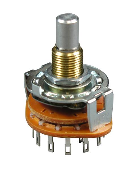

You may be better off with a larger rotary switch designed to be used.
Mount it in the guitat like a 2nd tone pot.
