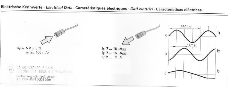

I am in the machine buisness, and have my own old lathe in my little hobby workshop, i scored a Heidenhain glass scale at work, i want to use for digital readout of position, i have a program on the PC, but it only handles 0-5V TTL signals, and the scale put out sine wave.
I have been searching the net, but only found out i should use a Schmitt trigger to avoid noise.
I am not able to develop schematics, but i can build it if someone have the schematics.
Here is a scan of the sine wave from the Heidenhain mounting instructions
