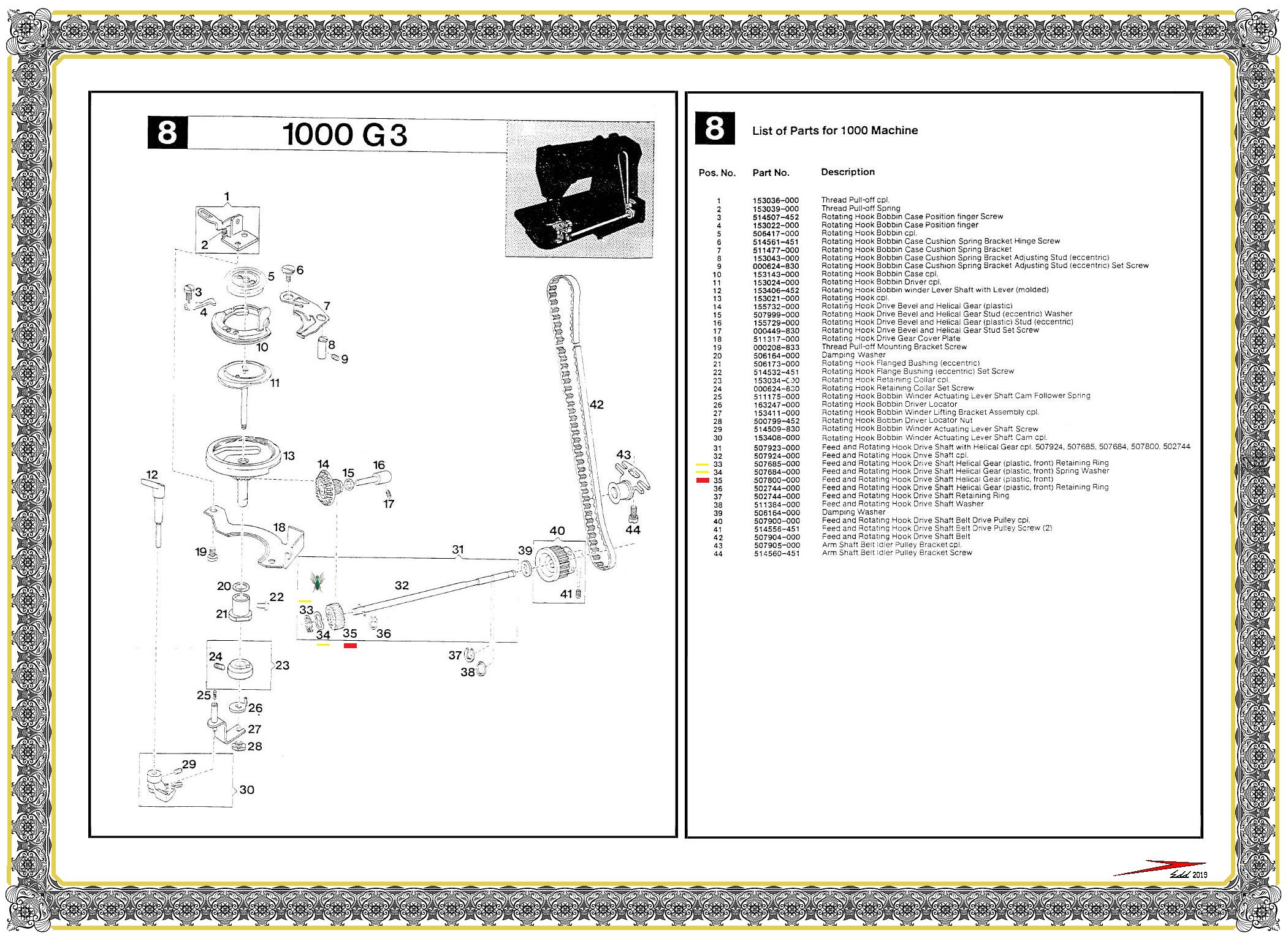

Hi there, I’m new to this forum and the question that I have is... is there a layout for the inside of my Futura 1000 and where can I find parts for my machine. I live in Amsterdam and I have been searching the Internet.
My machine stopped working and I decided to fix it myself. When I opened it, I found a part, gear/cog completely chartered. I don’t know where it came from. The result is though that the bobbin doesn’t turn. Can anyone advise me?
Thank you so much

Sir or Madame Vania . . . . . . . ( . . . . . an unfamiliar names gender, to me ?)
MECHANICAL BLOW UP AND PARTS LIST . . . . .
Logic deems that your fault certainly would seem to be, the plastic gear ITEM 35 having had its retaining clip (33) and compressioion spring (34) loosened and popped off the end of shaft (32) and thereby, letting the gear fall free, down inside.
OR . . . . . its plastic having developed time related brittleness and having split, and the resultant two gear halves fall down inside.
73's de Edd . . . . .

Hi Vania,
I've two Futura 2000s that had the same problem. OP is correct, the hook gears have gone brittle and broken.
Can your Futura 1000 wind the bobbin in situ - if yes then this may help:
You can buy a replacement set on Ebay - search for "futura gear 382980". I purchased one set to try from the "Evernice" listing - it arrived and works fine in my futura 2000 (cost £9.60 but I see it's now £8.45 so I've purchased 2 more sets - note these are remanufactured gears, not original. I'd avoid originals in case they have been stored for years! Also be careful what you buy because one gear has a second hole for the bobbin winder function, some listings may say the gear set is compatible but they are not. Repairing is reasonably simple but do make sure you understand the needle / shuttle / foot timing before taking apart! Also you may need to replace the motor mount inserts, they crumble with age too. I made mine from high density foam.
Hope that helps, good luck

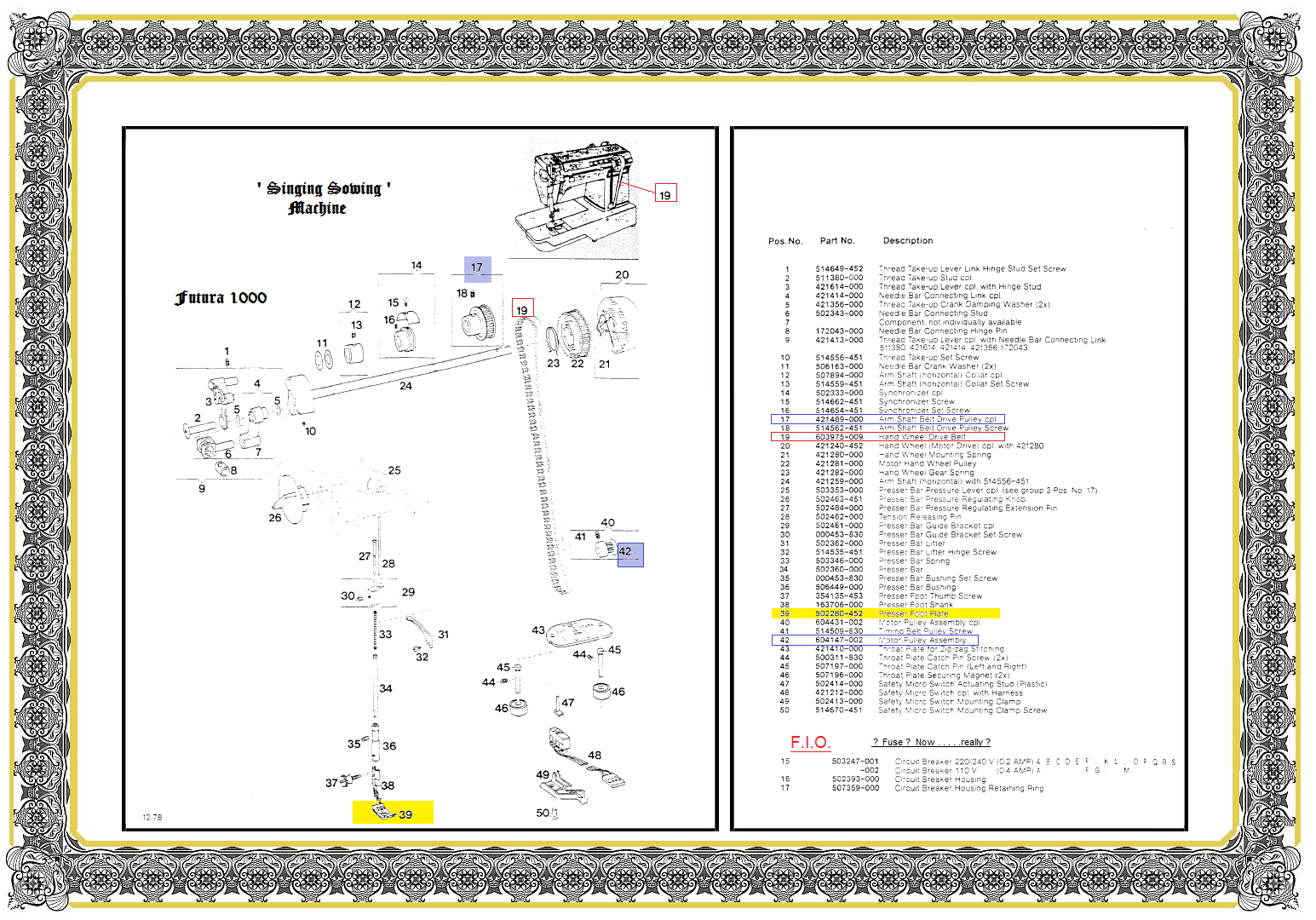

The Futura 1000 looks very similar to the 2001. I have several throw outs of which 2 are now working. Servicing these is less than straightforward and accessing the electronics is quite difficult due to the way it is packed in with interconnecting wires everywhere.
Disconnect the machine from the mains supply.
The top should slide off towards the hand wheel - it is held on by 2 internal spring clips that can hold it very tight so sometimes I use a screwdriver to gently get it started. This will allow you to see most of the needle drive mechanism.
Next remove the left side cover to expose the needle bar.
You can now investigate the needle drive mechanism to see what is going on.
Regarding the internal fuse, if fitted this can be accessed by removing the bottom cover. For safety do ensure mains is disconnected first.
On the Futura 2001 the fuse is for all the power to the machine, there are no other fuses on the electronics boards.
You can get a parts list here - it also has some exploded views of the machine that may help:
https://www.manualslib.com/manual/154332/Singer-Xl-1000.html?page=8#manual

At the very simplest of analyzing :
Can you try this . . . .?
Cut out a small hand sized square of single weight / ply cardboard stock . . . . . akin to the weight used on cereal and cracker boxes.
Manually get the needle UP using the machines right ends MANUAL HAND WHEEL.
Lift the pressure foot up and insert the edge of the cardboard ( matte side down, if there is being a glossy side ) and let the pressure foot back down.
Now take the manual hand wheel and "sew" the length of the cardboard . . . . . . . thus confirming that the sew mechanics has enough drive
" oomph " and proper mechanical functionality to accomplish the multiple needle pierces and accompanying creep forward , materiel feed action .
If so . . . . . I would be wanting to expect a broken drive belt inside or a cog tooth/teeth broken off on that ( dry rotted / brittle) cog belt.
If items 42 and 17 are being of. . . . . A G E D . ./ yellowed / C R A C K ED *** plastic or DELRIN construction, they might also be suspect. . . . . .no question on the aged aspect.
( *** ¿ Some how ? . . . . I have a gut feeling that they are going to be cheep molded " potty " metal.
TECHNO REFERENCING . . . . .Parte Deux
