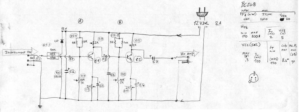

Hey folks.  This is my first posting in the forum.  I have been working on making my own solid state amp from scratch...having some problems i guess understanding some basic concepts.  in short, this is what i have built ....  it doesn`t seem to put out any sound.  I`m hoping someone will have the time, knowledge and the grace to guide me in the right direction with it.  that would be super..  I`m thinking of this little thing as a pre-amp.  I`ve also been working on the secondary stage of the amp, but perhaps think it would be best to get the preamp up and running first.  Is there anything that sticks out as "could be changed and then it should work".
I`m hoping whoever answers is a friendly sort.  I`m not shooting for the Nobel prize with this design, just something to plug my guitar into and get a bit of sound and tone out the other end.  Any help is greatly appreciated. Image shouold be attached of the hand drawn schematic.  Thanks!

Hi there SILVERsound, and welcome to Electronics Lab  :)
How did you calculate the resistors? I belive they are totaly wrong, with maybe hte exeption of the colector resistors! ??? What are the amp used for? A guitar preamp? Have you measured the voltages on the transistors, I belive they are badly saturated.
Oops, i belive I am tired, i did not saw that it is a guitar preamp!

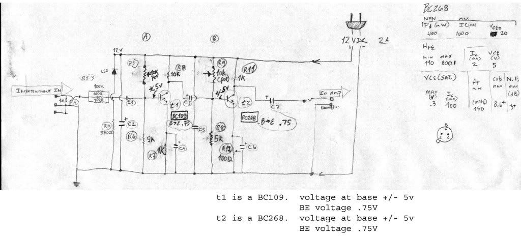

I`ve tried a few different things with this amp....changed the resistors a bit on the collectors and emitters....and biased the base and am getting a BE voltage of .75
seems like it should now work....at least some sound should be coming out right?
but still nothing.
any suggestions?

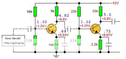

You need to learn about how to bias a simple transistor.
You still have the transistors saturated (the collector voltage is as low as it can go) so they are not an amplifier.
I corrected the biasing so that the collectors of the transistors can swing up and down and swapped the two transistors so that the low input impedance of the second transistor is driven from the low output impedance of the first transistor for low signal loss.
The circuit is completely wrong for a guitar pickup that needs a preamp with a very high input impedance and low gain. This circuit has a low input impedance for a dynamic microphone and even has too much gain for a low level microphone.
Here is a simple guitar pickup preamp circuit:

the amp still isn`t producing any sound.  any ideas what i can do from here?  i have put in the resistors on this drawing as audioguru suggested, measured the voltages and noted the readings....  scratching my head today.  um....  what`s wrong?
What is the input source? A dynamic microphone? A dynamic microphone has a coil and a magnet. This preamp will not work from a common electret microphone unless the microphone is powered from a 10k resistor connected to the filtered positive supply.
The input impedance is too low to be driven from a guitar pickup but it might produce some weak bass sounds.
What is at the output of this preamp? it will not drive a speaker, it drives the input of a power amplifier that drives a speaker.

Yes, if the capacitors have correct values, have the correct polarity and the amplifier has an input impedance of  47k or more.
am i right in my understanding....that these voltages i posted as "measured" from the made version of audioguru`s schematic are in the "ok range"?
The voltages show that the mic preamp will work well.
should i proceed to the next step?
Yes.
