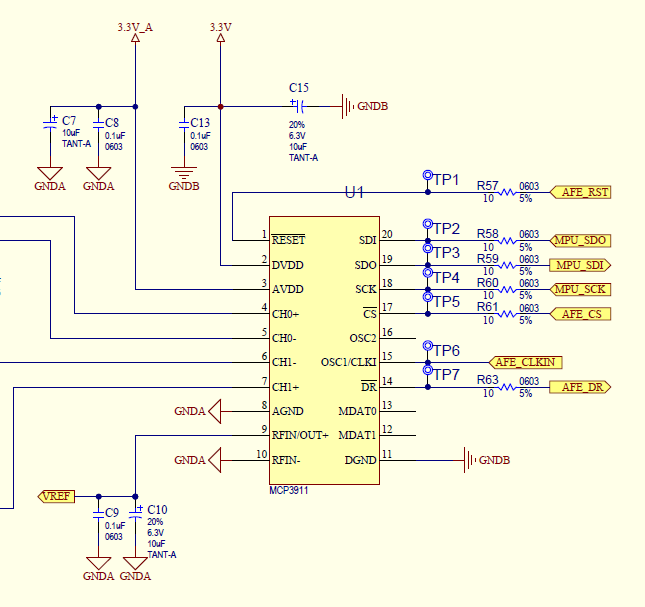

Hi,
I am trying to read ADC channel values from MCP3911 using MSP launchpad using SPI protocol. When i used Arduino Mega the protocol is working fine. But when i use any TI devices i am having a problem, it always gives me all 0'S or 1's.
I am using energia for MSP devices. Any i have chosen the appropriate pins as defined in the enegia pin layout.
msp430-----
static const uint8_t SS = 8; /* P2.7 */
static const uint8_t SCK = 7; /* P3.2 */
static const uint8_t MOSI = 15; /* P3.0 */
static const uint8_t MISO = 14; /* P3.1 */
Can someone help me troubleshoot where i am going wrong?

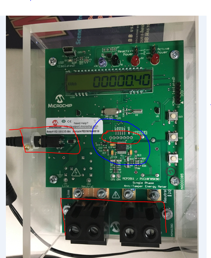

Will there be anyother connections running between MSP and MCP other than SS, SCK, MOSI, MISO?
Where to connect GND? and is it required for the SPI?
Oscilloscope shows the MOSI line from MSP is outputting data as expected. Also will pullup, pulldown states of pins matter?
If u have a moment, it would be great if you can try the code I posted above and see if ur having any issues on your setup.
Buy the way, I am using MSP430FF5529 launchpad, energia 17..
Thanks in advance.

A common ground between the devices is required.
Have you checked for logic level compatibility?

Hi kellys_eye, thanks for your reply.
Sorry for my late response, i don't think it is the logic level causes trouble, in fact there is another micro controller on the board that is connected to the MCP3911 (only hoping using this to develop the model), so i am thinking if it will fight the MSP430 for control over SPI and lead to unexpected results...We'll get rid of it and develop our on Analog front end. Will check and see if i can read the values now. Will post if i see any trouble doing so. I just read the control register and its outputting the setting i write.
