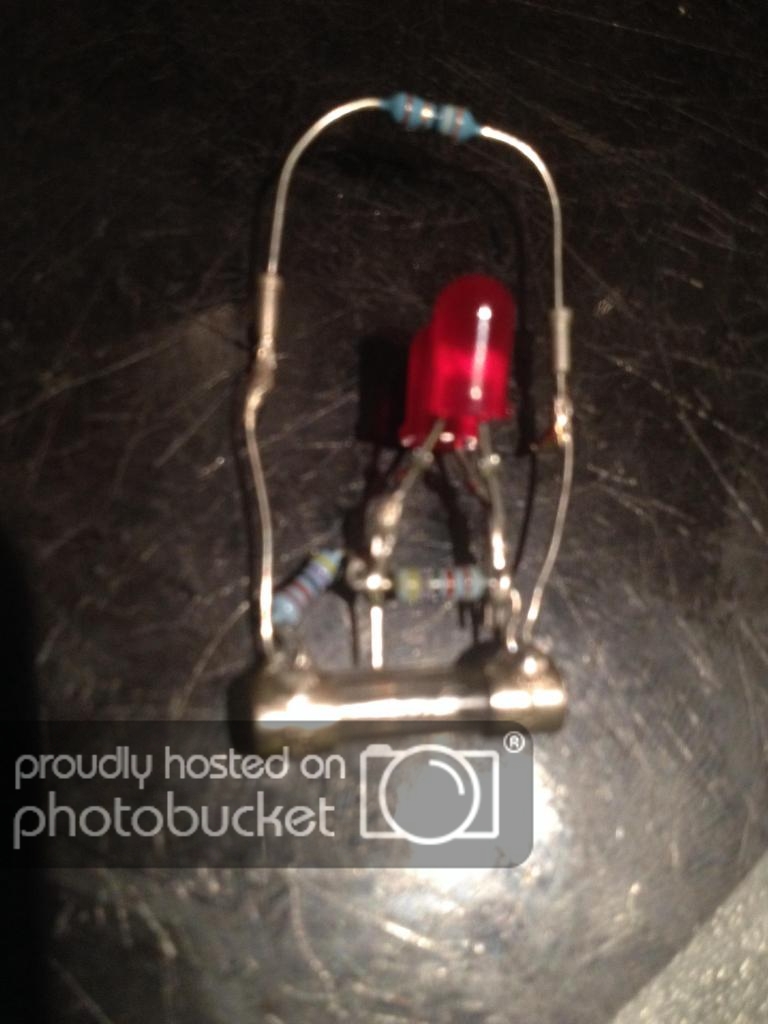

ok khrisblueNZ,
Is this correct ?
whats my next move?
Was I right with 2 LED's polarity reversed from each other ?

Haha, that's great Pete! I would cover all of it, apart from the fusible resistor, in hot melt glue or similar, to give it some structural strength and prevent it from touching other parts. But you've got it, and you even replaced the bicolour LED with two red ones in anti-parallel. I thought you said you were a novice!
OK, do you have a multimeter? What make and model?

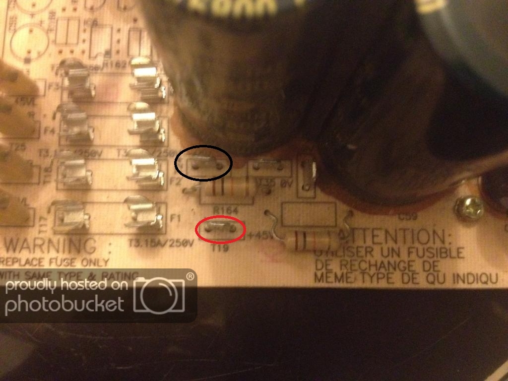

Next, can you upload some fairly close-up photos of the part of the circuit board close to the heatsinks. Take the photos from directly above the board, in natural light if possible, no flash, no direct sunlight. See https://www.electronicspoint.com/resources/how-to-take-photos-of-circuit-boards.6/

Will take some photos tonight

Hi again. Sorry for the delay.
Yes, those pictures are very good, thanks.
I'm asking a lot of questions in this post. Can you go through it point by point and respond to all of them please.
When you said in post #18 that you had accidentally connected positive and negative voltages backwards, what exactly did you do? And did you make the same mistake on both channels?
And the four fuses in a row that blew, that you replaced with the fusible resistor things, they're F1, F2, F3 and F4, right?
And one of the output transistors is short, but the other three are OK, right? The meter on the 2000 kΩ range shows "1" (same as when probes aren't touching anything) when you measure from collector to emitter?
Yes, the transistor you linked in post #35 is the MJ15004. I'm not sure whether to suggest that you replace all four of the output transistors, or just the faulty one. The other ones may have been stressed, and that multimeter test is good but doesn't guarantee that they're OK. They're not very expensive. How do you feel about replacing them all?
Can you please unclip the four metal clips that are holding the driver transistors onto the sides of the heatsinks, and tell me the markings on those transistors. There's an error in the schematic and I need to know the actual part numbers.
this is what colour should have went where, i had them reversed by mistake !!
yes
yes
depending on cost, i dont mind replacing all four to be on the safe side
numbers on the smaller transisters under the clips is
D1763
F 952
and
B1186
E 939
soorry i dont know how to use the quote function lol, YET!
