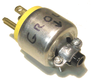

I just took a grounded AC plug and stuck a banana jack in it tied to the ground pin:
You can also buy them but this is cheaper if you have an old banana jack laying around.
The computer case is most likely grounded but only when it's plugged in.
Get a DMM and measure the resistance from the case to the AC ground pin when the computer is unplugged. It should only be a couple of ohms. Your wrist strap from the wrist contact to the banana or clip should be at least 1 megohm.
