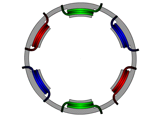

Sir Kelly . . . .BEE
Me thinks that you are dreaming of an impossibility, in your being able to use / repurpose that existant wound rotor to construct a motor.
With its existant wire sizing, and using a low voltage supply, in resulting in a power plant being minimally able to drive a mouses balsa go-cart at a creep.
Its needing an added complete construction of an armature and its 20 contact segments and 2 brushes with their holders interwired to those fine wire rotor windings.
Built to dynamic balancing and holding within a .001 in rotary eccentricity.
Then a stationary, fixed position ceramic rotary ring magnet, incorporating 20 peripherally magnetized, side by side, alternatively polarized segments.
surrounding your rotor.
That would be the simplest manner of fulfillment of the magnetically fixed field requirement that the rotor repels against.
Forbid . . . shudder -shudder . . . . the having to wind 20 sets of fixed electromagnetic field coil sets. . . . . vice the preferred use of a fixed permanent magnet field source.
The action would be an inverse of the depiction shown below, wherein , the shown rotor windings need to be rotated 180 degrees from their shown positions, such that the magnettic field is shooting outwards instead of inwardly, thus making them the peripheral windings of a rotor.
Then the 6 side by side ( you need 10 ) magnetically polarized RED-BLUE segments of the shown rotor is ENLARGED in size, so as to SURROUND the rotor and just establish rotary clearance of .005 in with the internally spinning rotor and the fix mounted magnet.
