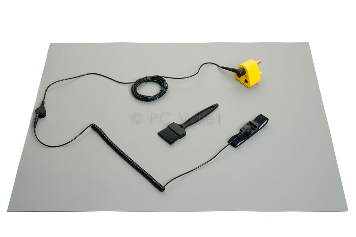

I'm an electronics noob, and I mean in the very early stages of learning. I live in an apartment so I have limited space for a workbench and I found this steel one on harbor freight http://www.harborfreight.com/multipurpose-workbench-with-light-60723.html. I like it because it's small, has lights and an outlet. I know a steel workspace is a bad idea, but my question is, would this be ok to use if I just put a sheet of plywood on top?

personal thought would be that it would be best to have something thicker and more durable than the leather cover. do the plywood layer
and if you think you may get into electronics a bit deeper as time goes by, then it would be wise to also invest in a proper bench top anti-static mat and wrist strap
this sort of thing ......

Steel frame and top are okay, but place plywood covered in something like leather, as @bushtech suggested, to prevent parts from slipping around. Use the anti-static rig that @davenn showed to ground yourself through a high impedance (about one megohm) to protect static-sensitive devices from charges that can build up on an ungrounded human body. This rig will discharge static electricity on your person without providing a low-resistance current path through your body to ground.
