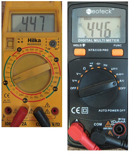

Sorry if this is all a bit basic on an Electronics forum - but i will ask regardless
The fan is clearly labelled as 12v 0.9a & 10.8w
done a quick check on it with it wired into a 12v supply, and I checked that it was 12v.
the fan runs perfectly and is easily as powerful as it need be,
However it is only showing 0.45 amps, so I wired it into a second multi meter and same result.
as this is quite pivotal on how I proceed with this little project, am I missing something obvious or not understanding something obvious?
wonderful if it is only 0.45 amps as this would make it only a 5.4watts fan, and should give 4 hours on the 18v battery that is rated at 24wh (3 hours run time would do)
And this would also suggest the use of the usb powerbank (rated at 5v ... 1A/2.1A (max)) as it would only be drawing 1.2A (?)
Although mu gut feeling is the 18v Li-ion would be the better choice, even if that did mean step down and power cut off things to be added (but that would all be very intereting to do and far from unwelcome)

Perhaps the 0.9A rating is for the peak (start-up) current, rather than the normal full-speed running current?
Bluejets
Oct 5, 2014
7,374
Oct 5, 2014
7,374
Without seeing any fan specs, impossible to say.
Could be wrong label on the fan, different fan, or the fan may have an internal pwm regulator so the Op is seeing just the average current.
