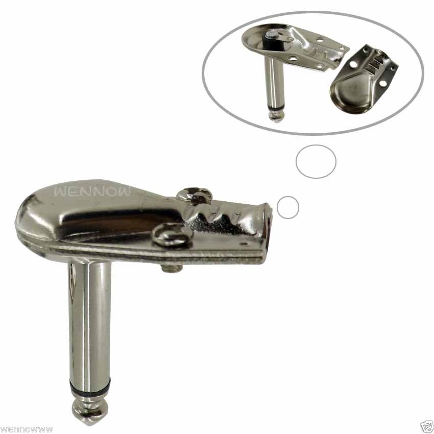

I just remembered one method I have used in the past quite successfully to bring power out of a slow turning wheel, was to use a 1/4" phone plug and jack, the jack was mounted to the base and the 1/4" mono plug was used as a pivot on the wheel. .
M.
