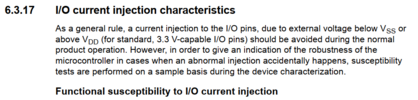

I have been working on a SMT32H747 MCU based HV PCB board. The power supply pins of MCU is only supplied with 3.3V (max can supply 3A). Moreover, I also connected MCU's VDD1V2 (1.2V) pins with 3.3V.
Issue noticed so far, MCU is heating too much. And damaged couple of IC.
Note - MCU is not loaded with any firmware, still heats up. I'm suspecting short circuit on power supply pins of MCU.
Can anyone help me finding short circuit nets here? Also provide me your suggestions. Thanks
MCU Power supply section image (Sorry for confusing schematic net names) https://imgur.com/U8ChMLy
Looks like the obvious error, doesn't it?
Instead of suspecting, measure that with an Ohmmeter.
At first glance nothing obviously wrong with the schematic. Doesn't mean your PCB is correct. There may be errors in the layout or during manufacturing.
  • Check a bare PCB (no components assembled) for any short circuits that shoudln't be there.
  • Check the placement and the orientation of all components.
  • Check the layout for errors like mirrored pad layouts. Especially when using double sided pcbs, make sure the pad layout on bottom is mirrored becaus the components on bottom are placed mirroted, too.
    Check the schematic for any floating inputs on the mcu. You should never leave CMOS inputs floating (not connected to an output, pull-up or pull-down resistor).

Is this part in latchup ? Possibly due to power supply sequencing not correct, or out of spec
pin V per below.....
Part dissipates > 1W, so not exactly cool to the touch unless heatsink.
