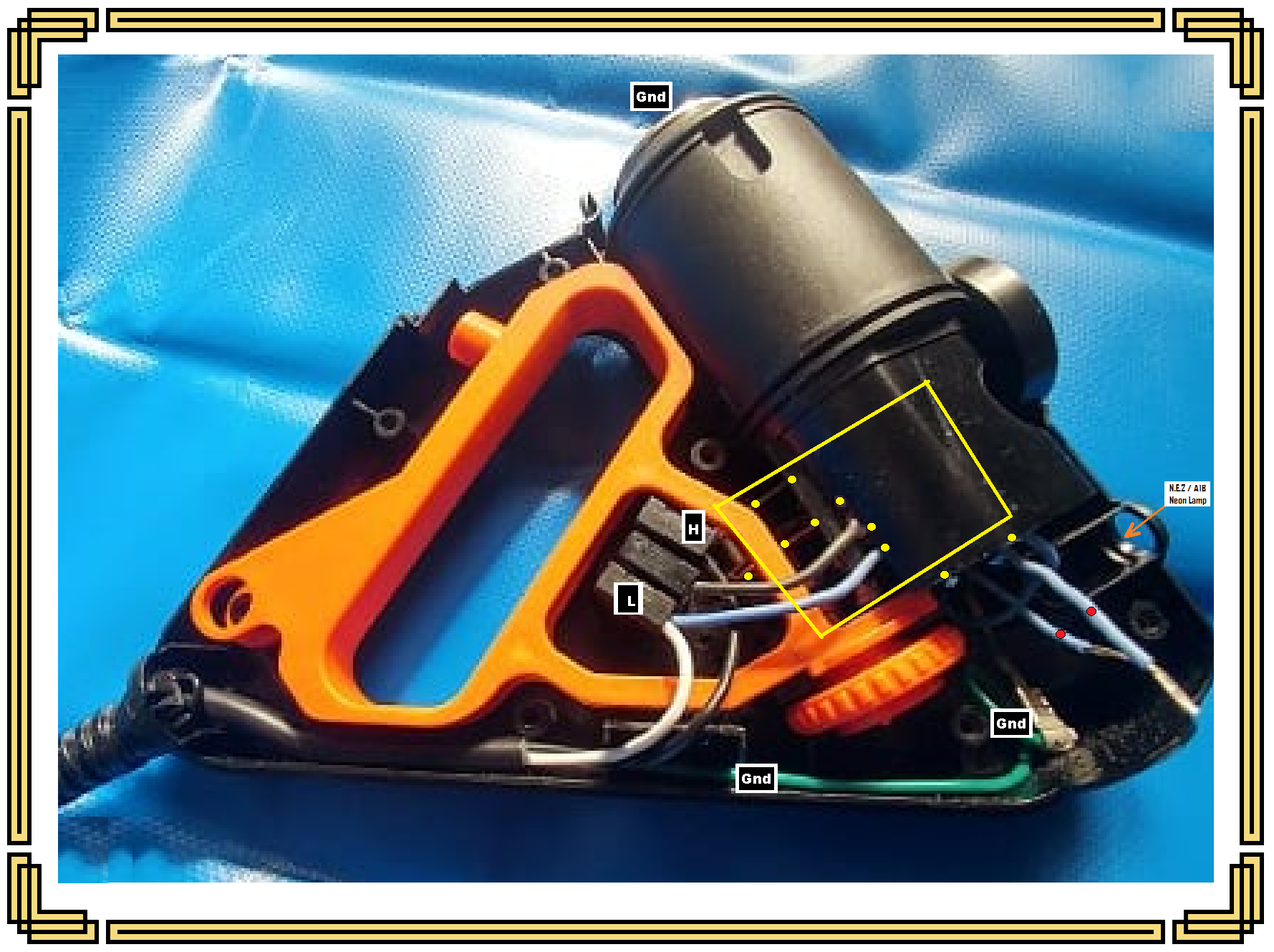

Thir Chipmaker . . . . (Whassamattahyou? never heard anyone wif a lisp ? )
If you refer to the first photo below , I am placing all of the markups that I seem to be able to confirm.
The AC power connections and their standardized wire colors are going up to the three BLACK terminals, where they then end.
After that, then its being their own helter -skelter choice of wiring color coding.
The GREEN safety ground wire at the bottom should go to any externally exposed metal that can be touched on the unit.
e.g. . . . . .
I only see the vape elements Stainless Steel holder ( at the very top of the pic) and . . . the unshown . . . . flexi metal hooka pipe that twists around in a spiral and then extends afar on upwards from that area... .looking for a set of lips.
My YELLOW boxed area and all of the YELLOW dot areas are needing a hands on examination . . . ergo . . .that I no can do.
I am " consuming " that the two RED dotted blue wires were / are the connections into the Neon indicator lamp and its series resistor that you have now torn down.
That whole assembly, was once nestled down within the ORANGE arrows area cavity.
Last relevance to this photo, is being the orange temp adj knob, which must be mechanically adjusting one of the electrical contacts, as shown, by altering spacing on the fixed contact of the bi-metallic warp thermostat. Its action is being totally hidden away from my viewing.
Refer now to the final combo schematic / mechanical drawing of the perceived wiring connections of this unit . . . . .
Same H L and GND connections are being shown on the left side of this drawing.
If it has a MAIN POWER switch it must be inserted into the HOT AC line input where I have the BLACK X's showing
If the power switch is closed, then power passes down to the left contact of the bimetallic thermostat.
If the Temp Adjustment screw is not pressing down at the GREEN triangle contact area, it is being at its lowest temp setting and power passes thru he two closed contacts on to the one shot thermal cut out.
( Now confirm for me if that unit was being your perceived small " battery " ?)
The power flow continues on thru the heater assembly and finally makes a complete power loop at the L Neutral wire at the end.
Now, at no extra consulting charge, you can see that the neon lamp is being wired right aross the heater unit, so it tells you if / when the heater is being powered up or not, as the unit cycles.
Now we need the bi metallic strip mechanically/ thermally /physically positioned onto or very near the heater element.
Also, that thermal cut out needs the same mounting situation, wherein its internals melts at . . . .I believe that you found 180 deg C written upon it . . . .and it is then being an opened electrical circuit . . .FOREVER..*****
The lower GRAY inset reference relates to the electro-mechanico action, when the heater gets up to the set temp, and the cojoined disimilar metals strips different coefficients of expansion, will then result in them warping into an arc and thereby moving their associated contact away from the other contact.
Should you have adjusted the temp knob downwards at the GREEN triangle reference, it would have pushed BOTH contacts further downward, so that the warp would have to be even more severe from that position , that results in a longer run time of the heater and a higher upping of the temp before cycling off.
( There are being mechanical enhancements using springs, counterbalances, and even magnetics to create a MORE defined SNAP action in switching . . . . . but this depiction is just showing the rudimentary basics for you.
Now lets look back up to the top where I have drawn in two VIOLET triangles, which I think will coincide with the two RED dots on the bare ended two blue wires of the complete previous photo. . . .confirm that for me.
If you then had the neon and its resistor missing and those wires jumped together that would have the heater shorted across.
Then when you applied AC power, the heater was ignored, but the one shot thermal fuse BLEW just like a regular fuse.
Questionable damage to the thermostat contacts ?
NOW . . .another wiring possibility would be for that thermal fuse to be located further to the right and be between the VIOLET triangle and the heater.
In that wiring situation, a power up, would then have full 120VAC across the bimetallic strip contacts . . .probable spot welding and a tripping of that house lines circuit breaker.
With your only hearing a stutter from the breaker, possibly the first case fits the units wiring hookup.
Now, see what you can find. . . . .with ohmmeter in hand for testing and unit unplugged from house power.
Confirming the suspicioned earlier*****, plus any other possibilities.

Considering the small size of this unit and its handle aspect . . . AND a TEMP gauge ?
th
its not being my expected conventional water vaporizor . . .but an electrified HOOKAH !
I hold the same suspicions of an isolative / thermally insulative build up still being at the bottom of the unit, but from dried and caked vaping fluids.
With use of 409 cleaner / solvents /brushes/ gentle scraping, being the modes of removing of that build up.

A. Is the thermal protection mounted near the heat element. When I bypass this, it works perfectly again.
B. Is the adjustable thermostat which works fine.
By the way, it is a great unit. I highly recommend it. The company honored my three year warranty and replaced the first one. I have had this one past the warranty.

Hello,
I would never bypass a thermal protection.
When it is bypassed and the thermostat fails short, a fire will likely happen.
Bertus

A. Is the thermal protection that is going bad. I don't want to leave it bypassed due to the fire hazzard, so I might clean it, or replace it with a thermal fuse that blows at about 450 F.
