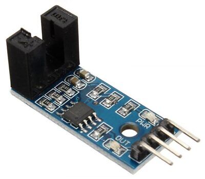

The IR solution would be best as it is a non-contact solution requiring zero mechanical mods. This only necessitates the sticking on of 'slotted' disk (or even carefully spaced black painted lines to interrupt the IR beam). Here's a typical (lots of other styles out there) version of detector but it needs the appropriate receiver amplification to get the pulse stream from it: (could be as simple as a schmitt buffer/gate device)
kellys_eye
Jun 25, 2010
6,512
Jun 25, 2010
6,512
Here's a slotted opto module that'll deliver a pulse stream if you can fit an 'interrupter' on the motor:
You should also consider a hall effect device and sticking a magnet on the motor disk.
