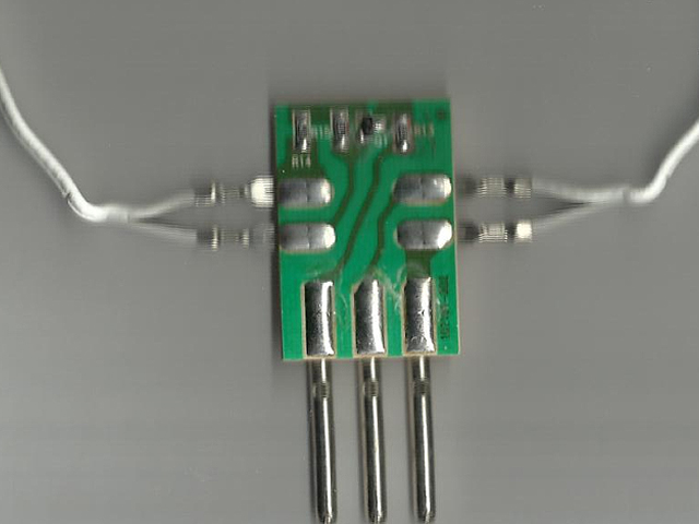

Hello all, I'm new here but seems the place to ask. I have a sunbeam electric blanket that is not heating. I do know about electronic repair and testing but I don't know much about electric blankets, this is the first one I ever owned. I tested the blanket for continuity with my multi meater and the blanket seems fine. The controller lights up and stays on but don't heat. I tested the control and its putting out power as well, but if its not connected to the blanket it goes into fault and the light flashes, but tested it said it was still 50.4 volts. But what do yall think?? I was going to buy a new controller for about 25 bucks to see if that was the issue. And before I hear new blankets are 30 bucks this is a queen size that is 87 bucks. So from what I said.. You think its the control unit? I took out the connector where it plugs in, on it are 3 inline resistors and a ( I want to call it a diode) but 2 of the resistors wouldn't give me a reading. But the others seemed fine, think I should replace those first?? I might work on it tomorrow so if I do ill post some pics of the small board to show what I mean. Any input would be greatly appreciated. Thank you.

Ohhhhhhh . . . Esteemed grand . . . great potato . . .and Revered Pooh Bah extraordinaire . . . .
We SURE could have used its model number .
But any chance that it is being this series and its controller might look like this ?.
also It has to have the 3 prong plug making GOOD and FIRMLY seated connection
before the unit is plugged into AC.
Any chance that the small board, which you describe its . . a . . looka . . .like a . .this ?
If so there are 3 small surface mount resistors on it and NUMBERS are on them plus there is one surface mount PNP transistor which can be tested by DVM in its diode test mode.
See how much of this info might be the same as your unit
73s de Edd

Hello, and thanks for the reply. Well when i made this post i was pretty tired, it was like 2 am and i used a phone.. so yeah was a lot of small typing.. (not big on phones for things) but .. the controller is different but that small board is the exact same one. I checked the connections over and they are strong solders and the multi meter tested them no problem for conductivity, so i don't believe the problem is in the pins. Im going to use your pic of the small board and highlight the 2 areas i believe the problem is. And im sure i can find the controller with a fast search. I can post pics of the actual unit here in a bit. Yes it is a 3 prong and the model of the controller says, PAC 0595 Style Y85, on the blanket theres 3 number sets, 3P 5H , RN 17280 and P.N. 116776-009 Rev. 1 Hope this helps a bit, and thank you so much for the reply.

This small circuitry is wired in between the two halves of the heater wiring of your blanket for temp sensing and it sends back a corrective signal to the main SCR based controller unit.
I now can make out the R1? of the first of 2 resistors, being side by side , then there is a Pee-in- Pee surface mount transistor and a final resistor.
You need to pass to us, all of of the numbers on each of the resistors and possibly any small alpha-numeric designations being on the transistor, for us to techno-translate.

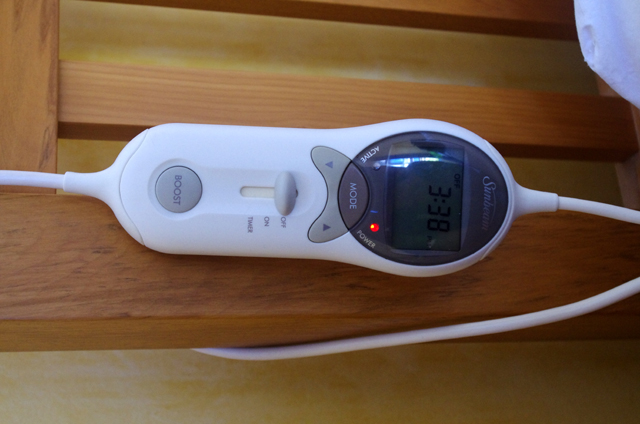

Hello all ! i have those Pics and a new report ... Those two Inline resistors ( or what ever they are) Did give me a reading. I used the conductivity setting and 2 chips gave me a reading and the other two didnt, but those two chips did give me a reading when i used the OHMs setting set to 200k. But here are those pictures, I took pics of everything and tried to get decent pics. I got pics of the Small Pcb Board, the controller in and outside.

The electrolytic capacitor, at top centre of pic _014, looks to be bulging at the top?
The component in the bottom left of that pic seems to be a wire-ended fuse. If so, check its continuity with your meter.

the inside of the controller looks brand new sadly, If it was a simple defect like that i would have already replaced it. i will check them though just in case but actually having it in front of you it seems perfectly fine =/

We will be interested in the small sensor board in your #23 photo of your post #7.
Have the board disconnected from the plug that it normally goes into, and then go into your meters OHMS mode and test for the SMD resistors values as being
wp_20161204_023-jpg.30702
22,000 ohms
1500 ohms
62000 ohms
Realize that we will then have to take a little foil slice out between R14 and R15, for correcting of shunted readings, and then solder bridge the gap later.
Also . . . whilst you gots ye olde ohmmeter warmed up and running good . . . . test for resistance of all possible resistance connections of the
PCBs central 2 Top and 2 Bottom tabs:
TL to TR
TL to BL
TL to BR
TR to BL
TR to BR
BL to BR
And then use DIODE test mode of the DVM for checking out the junctions of the PNP transistor Q1.
Collector is the sole tab at the top near the Q1 symbolization
Base is the bottom left tab
Emitter is bottom right tab
Expect in the range of ~500------ 800 millivolts for good junctions.

Ok so far I checked r 13-14- 15 and in the same order I got a constant on 13 of 21.4 on 15 got 1.5 and on 14 I got different readings, 60.5 and 59.9. Using my meter set to 200k omhs.
