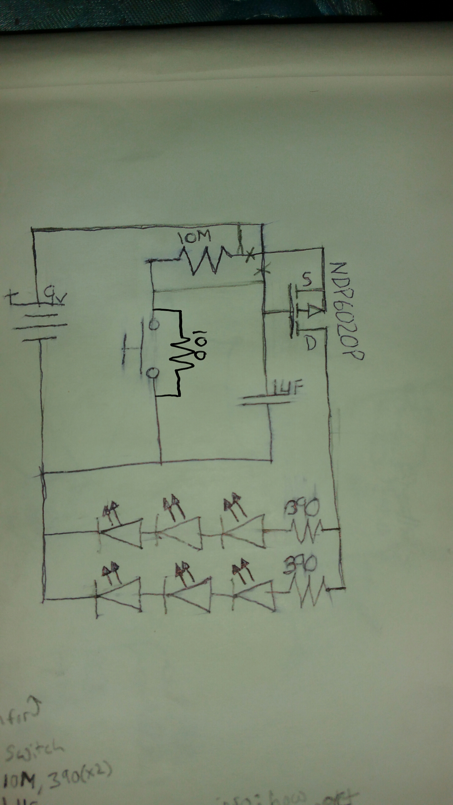

KMoffett
Jan 21, 2009
723
Jan 21, 2009
723
You will have to play with the R1 and C1 values for 3 minutes.
Ken
Added Note: the MOSFET should have been labeled NDP6020P for a P channel

Other than flipping everything over to an N-channel FET (lower Rdson per $), Ken's circuit is exactly what I had in mind. Also, a 9 V battery significantly increases the number of MOSFETs to choose from.

Jacob,
Q1 is a P-Channel MOSFET. (label should have been NDP6020P)
With 9 V you could do 6 LEDs.
AK,
That Mosfet was used for a 3V battery circuit. Changing the circuit for a N Logic level Mosfet would improve availability and cost.

Ok, thank you. I think I've figured it out. This schematic is very helpful.

The switch across the 1uF capacitor may not like the current from the capacitor. I'd put a 100 ohm resistor in series with the switch.
Do you mean between the switch and the leds/capacitor, between the switch and the capacitor/mosfet/resistor, or like this:
(yes, I drew the circuit on paper, yes, I screwed it up, at first)
