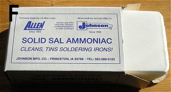

Alright. Soldering Iron Tip 101:
1) Get the tip clean whatever your preferred method is. Which will apparently be
the unpreferred method of others.
2) Use the sal ammoniac if you can find it in today's environmentally questionable
society. I saved my block from the 1970's and use it like Steve Johnson does.
3) Retin the tip with solder.
I'll mention, my company won't let us use the sal ammoniac. They buy this stuff in a
small tin called:
'I. C. Tip Tinner Lead Free R&R Lotion"
So apparently there are premixed tip tinner compounds.
My experience is, unless you clean that tip well, none of the above is going to stick to it.
Good Luck

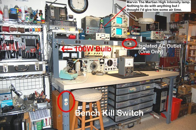

When you reach the end of the day, what to you do to insure you soldering iron is taken care of?
The biggest thing I do is ensure that it is turned off.
What I hate is returning to the shed after a couple of days to be greeted by a few glowing lights from soldering irons.
The rework station is less of an issue because of the airflow noise. Perhaps it makes me less sensitive to the other soldering irons :(
I eliminated that problem. As I walk out I hit the kill switch. Everything is off and I can sleep at night knowing it.
(*steve*)

Probably a good idea (and for other reasons too).
I am wary of powering down the rework station without allowing it to cool, but since it makes a noise (as I've said) it's not going to happen by accident.
My computer already powers down all of its peripherals when it shuts down.
I wish my bench was as tidy as yours.
heh. i have the poor mans version of this. i have to move all my tools from a closet to the spare bathroom to do any work and when i'm done i have to disconnect everything and move back to the closet...
ok, now i'm depressed.
