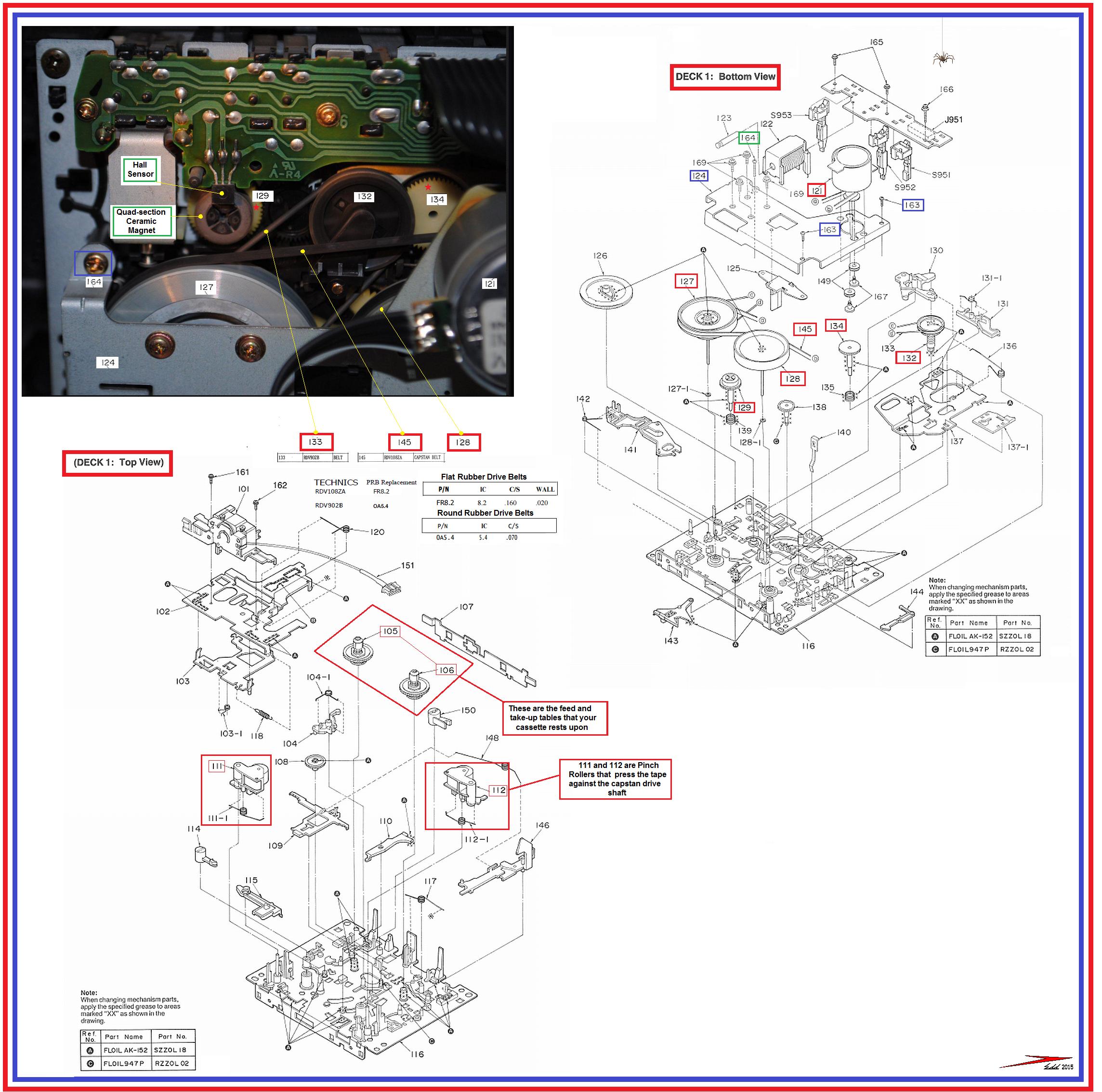

Sir Arch . . . . . . .L ?
Can you hear me . . . .can you hear me now ?
I had prepped up a blow up of your unit in conjunction with your supplied pictures and thought
that I had already posted info to you .Instead, its just residing on a flash drive.
The last time that you showed up, results were still uncertain, unless the video info Sir Martaine supplied,
whetted your initiative .
If your unit plays just enough to hear a sound snippet and the sound pitch is correct, that signifies that
the larger flat belt . . .called capstan drive is minimally fulfilling its duty.
The smaller round belt to the rear is the feed and take up reel function, and that will probably be the
fault. Specifically the take up reel, with your mention of a tape amassing internally of a cassette.
I'm using no more of my time at THIS instant until I hear back from you and your finds or needs.
Plus I don't know where you are . . .France . . .Uganda . . .Timubu . .as far as repair acquisition.
( Never mind . . . . when I logged in it said US of Amerikanski )
If you report back I can fulfill all procedural explanations and parts functions even down to its
smallest washer.
In the interim, I am posting the prior specified referencing that will be used along with the units
equivalent replacement belts numbers.
The belts are supplied by Electrovoice- - - - - Russell Industries- - - - - Projector Recorder Belts
which are all now being the same.
BEHOLD . . . . le Panorama . . . . .
( Left mouse click to MAAAAAAAAAAAAAAAG on up . . . . )
Whoooooooops . . . . .spilled out and onto the desk . . .didn't it . . . .
Base Image Host:
http://i.imgur.com/mLYdKka.jpg

What a great response! Thank you. I had given up but you make me think there may still be hope. I'm near Charlotte, if that makes a difference. The photos & drawings really help. Like I said, I had used some bands to replace the belts without any change. Looking at the photo, it seems that all of the problem is in quad section ceramic magnet. That's the one that stops turning. On the one side, it clicks a couple times before it stops & makes a humming sound. I hope that narrows down the problem for you & let's you help me fix this. Thanks again. Arch
