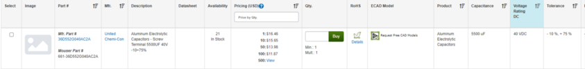

This is what I could find at Mouser.com. It doesn't have +100,-10%, it has +75-10%. I don't know how critical that is. I was thinking the new one would go inside that aluminum can so that it can be wired to the 3 ground points, but this one from Mouser is 35mm diameter, and the cans are only 25mm. So how does one replace these caps?

I found a thread in another forum that offered this chart of replacements, and these are more feasible to get, and fit, and cheaper too.
The question remains, do I go ahead and replace C1542 with the bad ESR, or is other troubleshooting recommended first?
