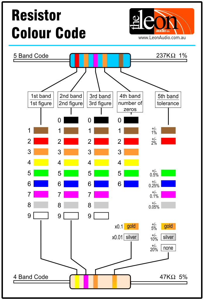

those bands give us the resistance value. as shown above. to have a precise match we will need a pic and all 5 colour bands, all i can tell you at this point is it is either a resistor with a starting number 1(1k,10k, 0.1k.... unknown) with +/- 5% tolerance or if the end band is yellow not gold then the starting number is 4(once again don't know if its 4k, 0.4k) with a +/- 1% tolerance
sorry i can't help you more

I kind of thought that might be the case, Does it matter what colour the body of the resistor is or is it insignificant ?

Body colour is often used to indicate a type of resistor .... metal film, carbon, hi voltage etc
