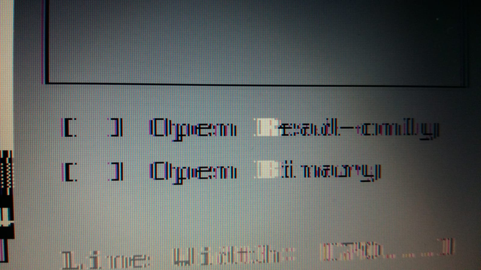

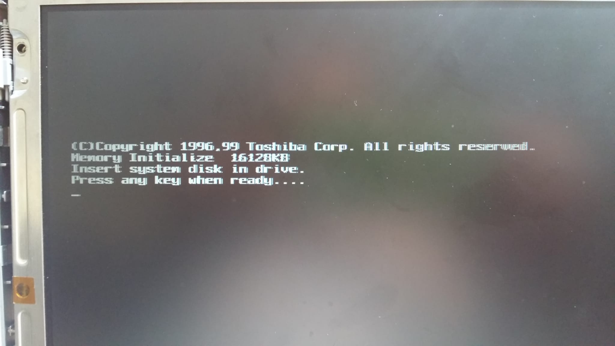

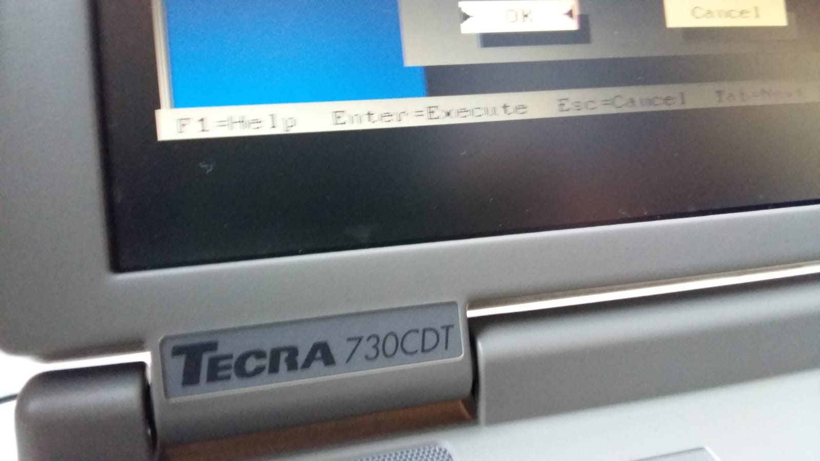

Hello, I'm looking for some directions to try resolve this problem.
I have this old notebook, Toshiba TECRA 730CDT, it works but the screen does this weird effect and I'm not sure if its caused by the screen itself or the video chip/card (or any other component?)
As you can see in the images its like every one line gets shifted to the right, and it gets worse to the right side of the screen.
I already reconnected/tighten cables from the motherboard to the screen and the flat ones on the TFT screen itself.
The screen is a SHARP LQ12DX03 12,1" TFT
Inverter seems to work ok, it has good back light so I guess its not the inverter (?)
Does anybody have a clue or where is the origin of this problem (and maybe solution)? Thanks!

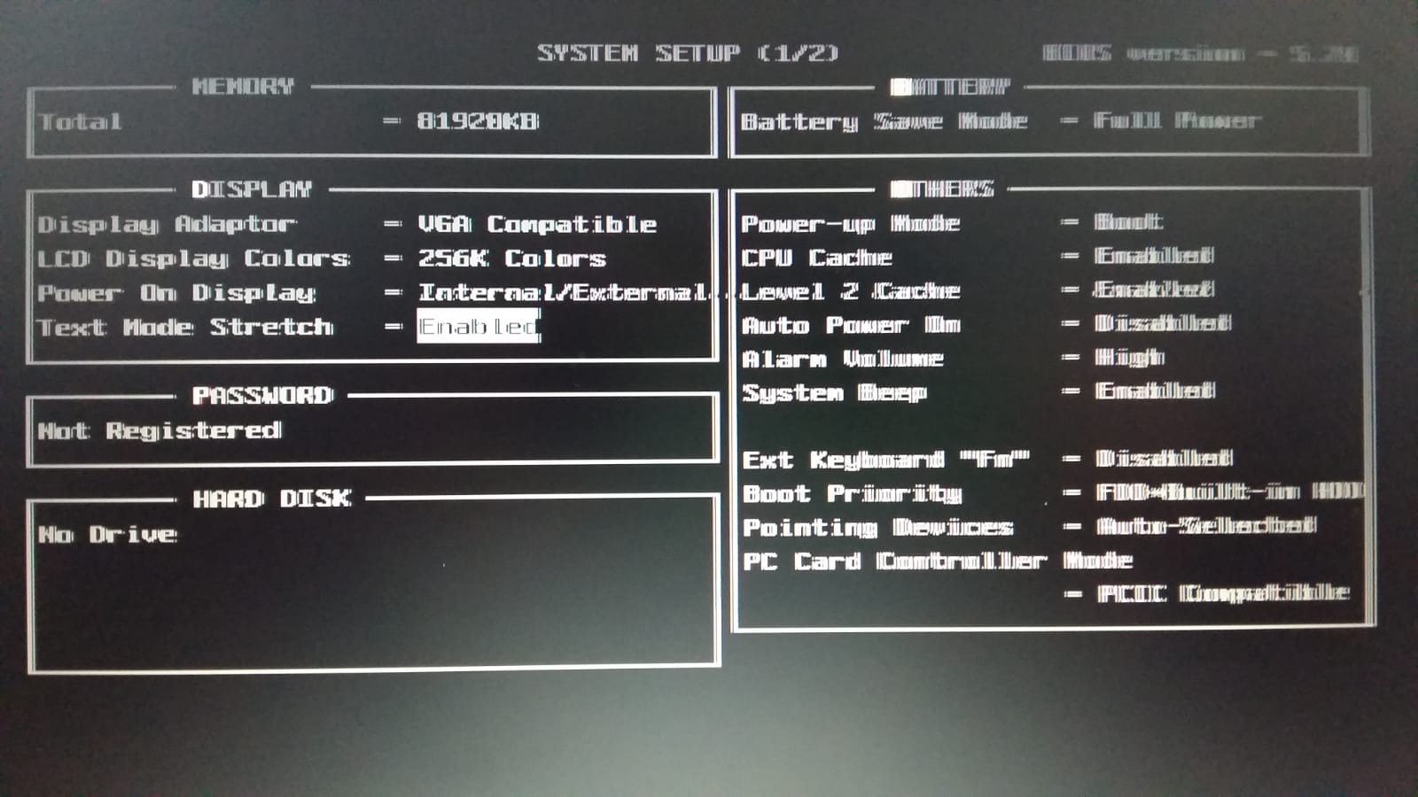

Hello,
Is the first picture from the BIOS?
It shows VGA compatible (640X480).
Are there other settings like SVGA (800X600) and XGA (1024X768)?
https://en.wikipedia.org/wiki/Video_Graphics_Array
Bertus
Yes it is from the BIOS, the other option is "Disabled" and not sure what it does but I tried it and nothing changed (it gives an error when booting again and goes back to "VGA compatible".
I tried changing everything on the BIOS, even if its not related to screen, just in case. With no luck.

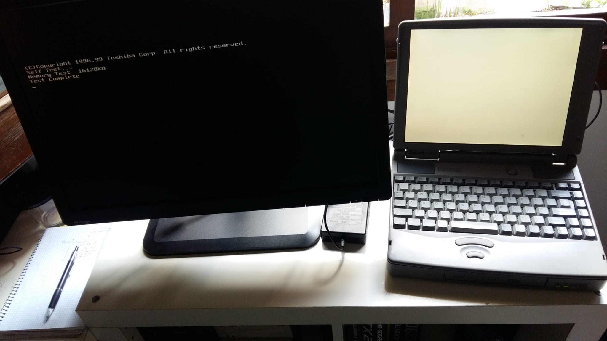

If it has an external monitor socket you might try that.
Yes I did that, with external monitor the image is crips and clear. The problem persists on the notebook screen.
There is an option in the BIOS to select between "Only internal or external" and "Simultaneous" where you see image on both screens at the same time. The issue on the notebook screen its always there, no matter the option selected.
I'm almost convinced its hardware problem, but still not sure if the problem comes from the motherboard/vga chipset or its on the screen itself. I almost dismatled the scren compeltely and re-assembled it again, but no change. I dont see anything wrong on the screen circuit board or cables.
I appreciate your answers. I will continue trying to locate where the issue comes from.

Has the device been dropped at any time or dismantled/rebuilt?
It looks as if the LCD filter may be out of place - touching at the left side, gradually increasing in separation as you approach the right hand side.
If you HAVE dismantled it did you go as far as separating the individual layers that make up the LCD itself?

If the pic is fine with external monitor that sort of rules out the laptop video driver section and points at the display itself as Kellys_eye suggests.

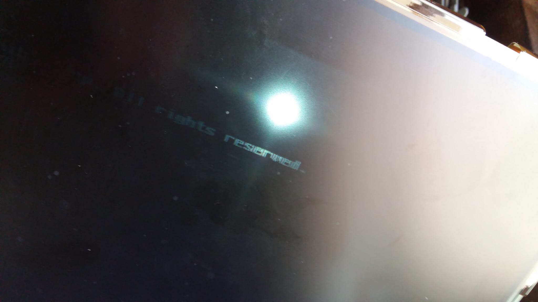

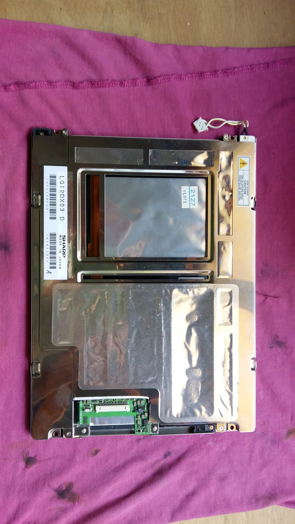

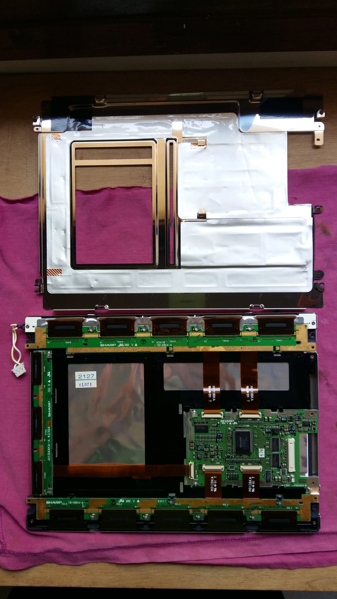

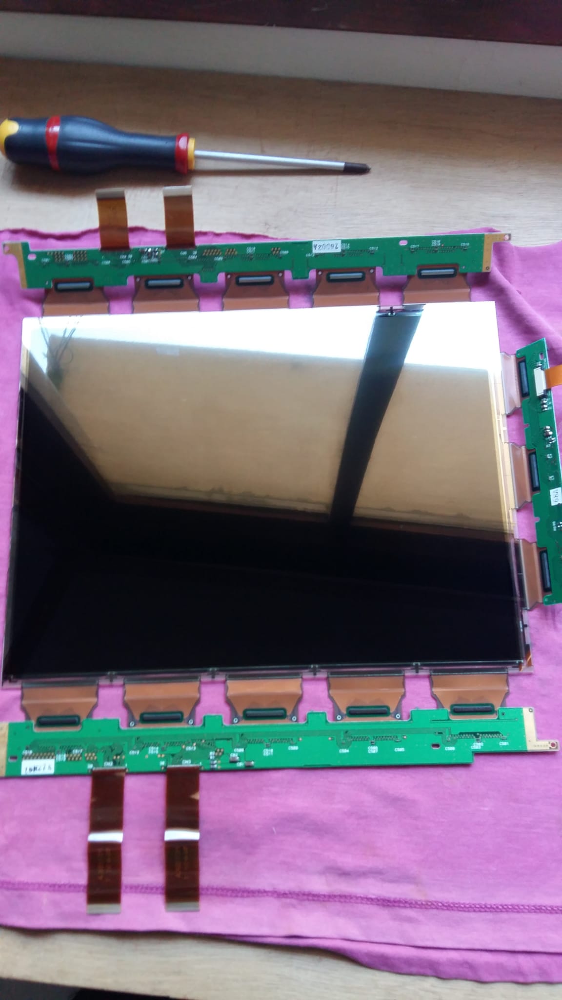

Today I dismatled the screen. The layers where fine. I did test it without the backlight layers and, as you can see in the photo, the issue persists:
(I used a phone light behind)

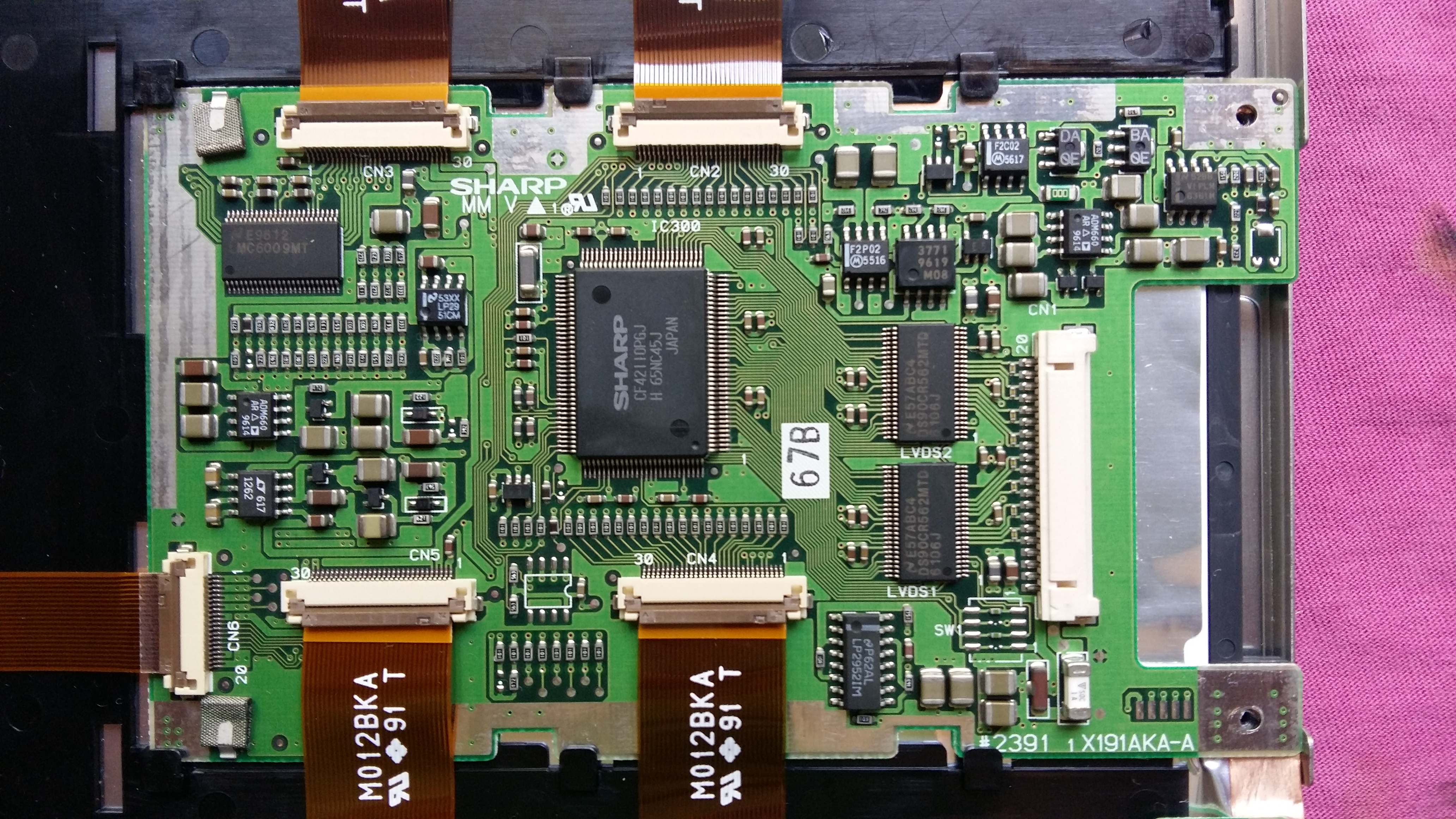

Here is the screen board, it seems ok:
Some more pics just in case:
After assembling all back together, same as before. (at least I didnt make it worse!)
Is it worth trying something else?

Long shot, but sure looks like a lost ground connection or power supply problem
causing 50/60 Hz modulation of a timing input......just a thought.
Regards, Dana.

I’ve had similar problems but with desk tops. Shielding and keeping cables away from each other usually fixed the issue, so a laptop grounding issue could be very likely.

thanks for the new answers, but it seems I made it worse...
Now the screen only shows a white full screen:
No mnatter what I do it only shows that white screen. I give up!

Do you have a good magnifying glass to look at soldering and flat ribbon connectors ?
Good lighting a must when you do it. Cracks in soldering joints, oxidation......bits on
detritus inside flat ribbon female connectors.
A fine wire brush to clean connectors (the ones you can access). Gentle is the operative word.
Regards, Dana.
