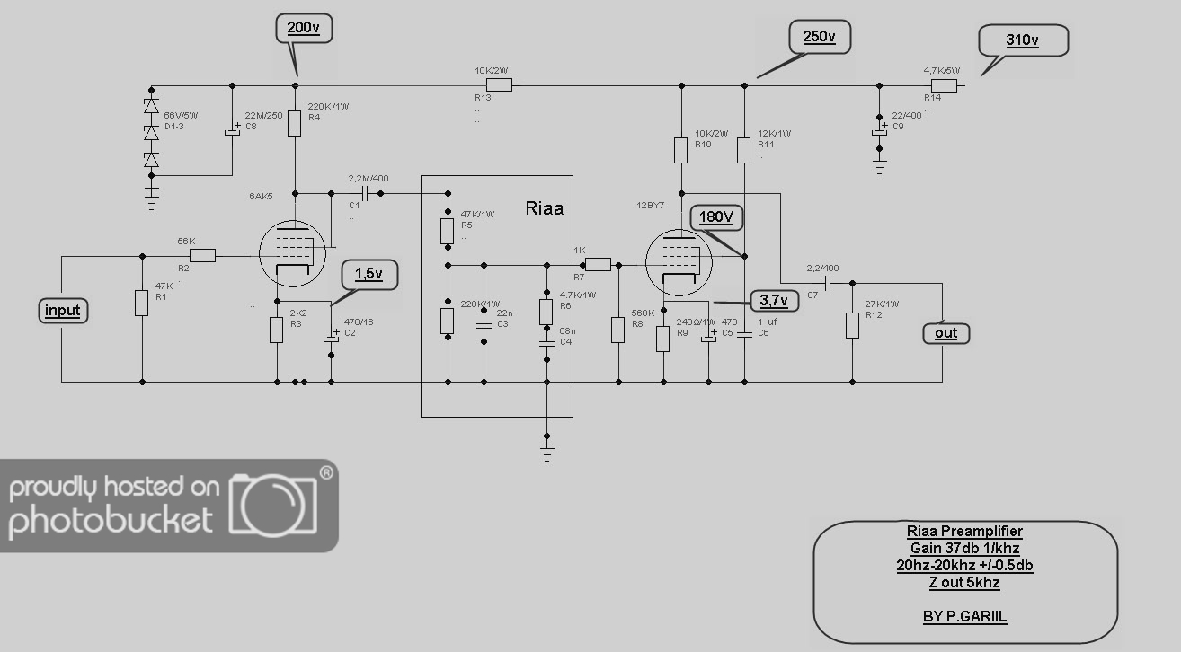

p.gabr
Aug 7, 2013
3
Aug 7, 2013
3
hello all again , i am from greece
my riaa preamp use hi frequency tube 6AK5 (triode conect) and interm freq 12BY7
response the riia curve +_ 0-8 db
Gain 37 db/1khz , z out 5k ,sn >53db
riaa carve
[/IMG]
my is violet line
my test is that (greek langu)
and
watch
sorry again for my englise

p.gabr
That looks like an excellent match.
Is your curve a measurement or simulation?

p.gabr
Aug 7, 2013
3
Aug 7, 2013
3
p.gabr
Check him basis of the above table
The process and the results showed in the video
Is measurement with good military analog meter .
All measure is +-0.6 about db except to 20hz when is -1.5 db down
the little bugs indications there may be
I use the electronic voltmeter ME-30, signal generator URM-127, output-impedance meter TS-585, oscilloscope TEKTRONIX 7603 +7A22 module diff amplifier (10 micro volt per division)
thanks best regards p.gavriil

5) Galvanic separated supply (just mentioning it)
I have designed all transformers myself with the thankful help of the then called Toroidal Transformers company.
All transformers work well but the OPT isn't perfect with regard to HF data. But it does sound perfect, believe me!
The reason for this post is however that I want you to comment on my latest design as attached.
It is basicly a Willimason Amplifier but I have taken away the push-pull drive part while making it work without feedback instead.
This amplifier will then not work well with all loudspeakers but perhaps with some?
The reason for this is the so called damping factor which is bad in my design.
With the use of KT88s the damping factor is only 8 times.
Best regards, Roger
PS
Here is also a picture of the bottom:
http://knopp.se/knopp/pa_black_bottom.jpg
