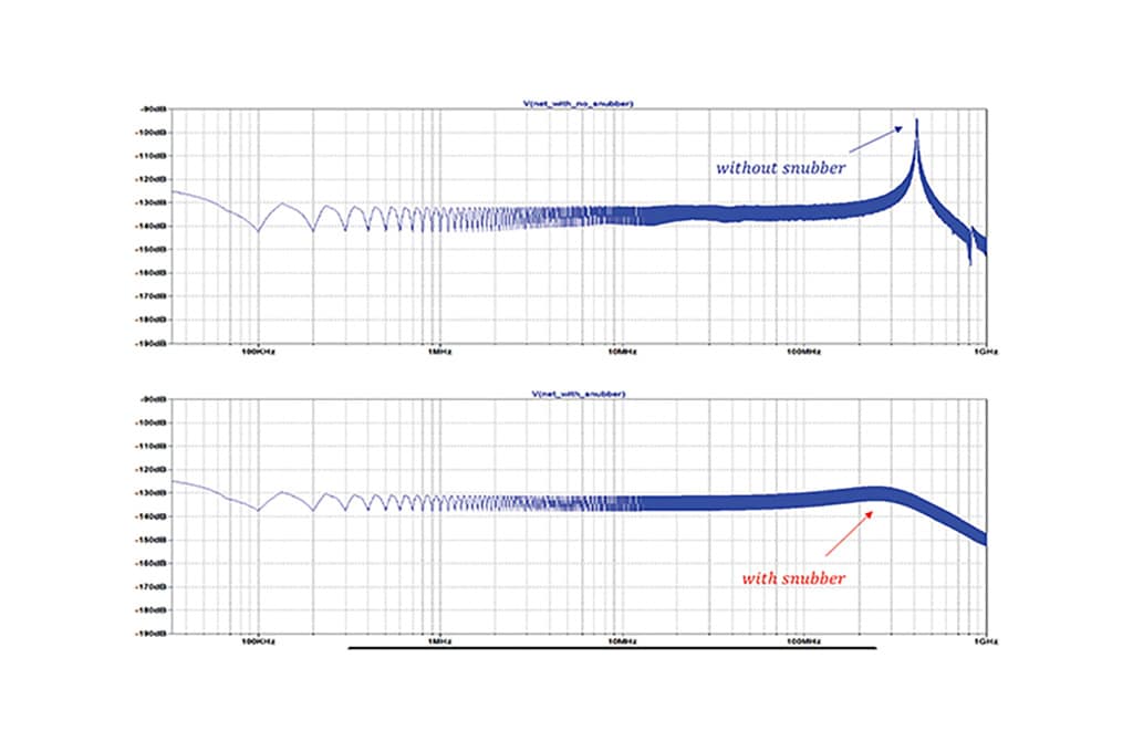

Sorry guys, I m back again to bore you with my questions!
I fix the transient spikes on motor stop....
Now I discovery another noise.
My circuit has two relays to move motor, another one to switch on/off the 12v motor power supply. When that relay switch on (only with load connected) another spike appear. I read somewhere that It Is normal due emi generated by sudden change of current and that usually the solution Is RC snubber connected in parallel to the relay endpoint. But, I m in AC, so if I put capacitor there mean that a little bit of current will flow in the circuit also with relay open....or not?! Di I understood well the location of snubber? Can be used in AC? Thanks in advance
