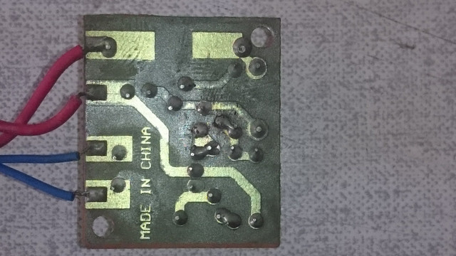

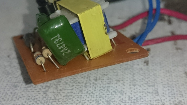

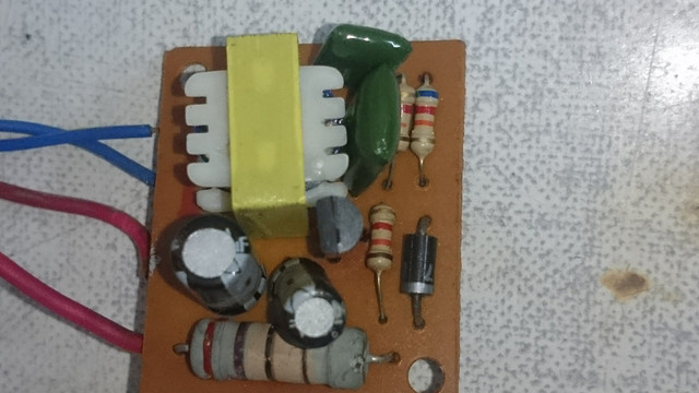

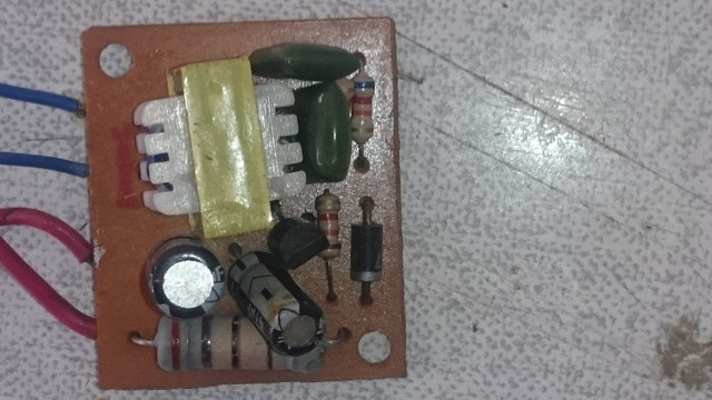

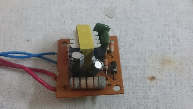

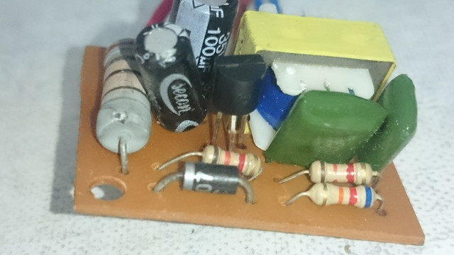

i'm having this electric door bell that make bird sound
it's not working the transistor is C945
i think the big resistor is burned, but i can't determine it's values since the middle color changed due to overheated

Resistors don't generally burn out without good reason so perhaps there's another issue elsewhere? Either way I'd make a guess at it being 27 ohms (a standard value) - it looks like it's a simple dropper resistor - maybe 270 ohms. Can you show how the board is otherwise connected i.e. power source (what is it, where is it from etc)

There must be a transducer of some kind (not shown) what is the nature of the one you have?

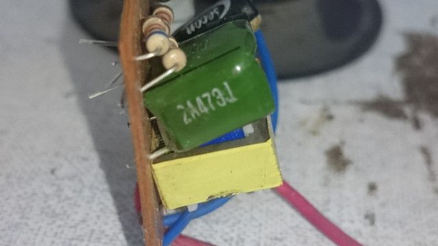

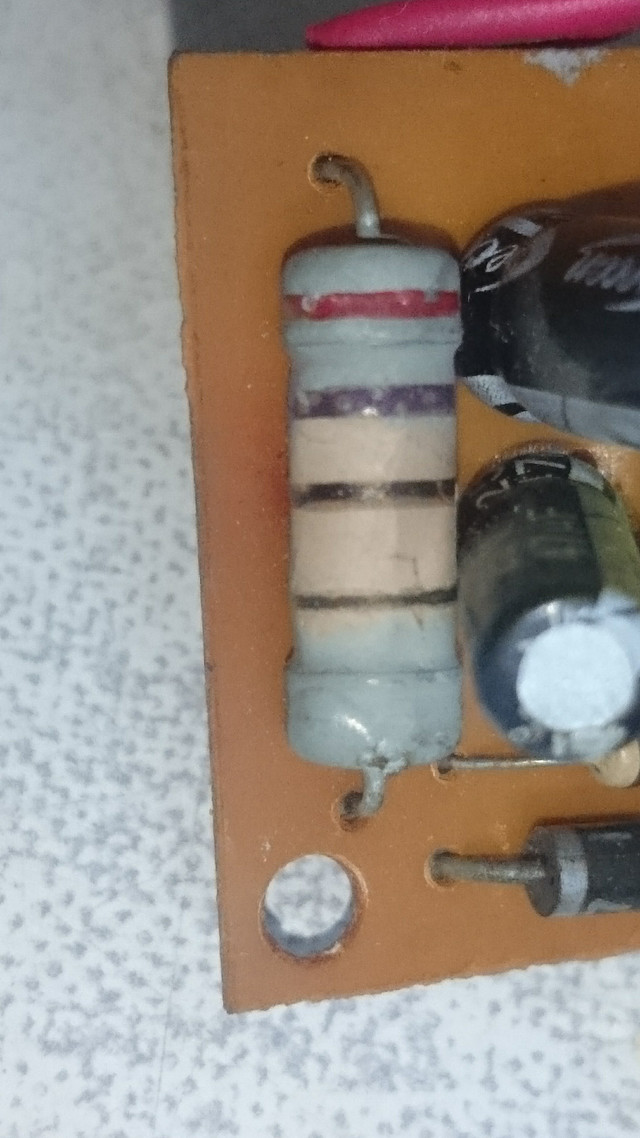

first resistor color from left is red then purple
3rd i don't know and the fourth i don't know

Red Violet is 27, if the third is brown = 270ohm, gold = x0.1, silver x.01
Measure it if you have a meter.

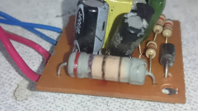

what transducer? that's the whole circuit.
it cant be, as Minder said ... there needs to be something that makes the sound, speaker etc
so there are 4 wires coming off the board ... 2 red and 2 blue
where does each pair go to ??

oh yes the blue are conected to speaker and the two red are to AC 220 V

Have you checked the LV output of the transformer, some have a thermal fuse embedded in the windings that sometimes opens.
Is the Spkr OK?

Have you checked the value?
It is a high wattage resistor so it would get warm and maybe discolour.
I would also do the check on the transformer.

in time, as someone else said earlier, there's a good possibility that the resistor overheated because of some other problem
If this is true and you dont find that other problem, then putting in a new resistor may cause its demise
Do the things suggested first and then sort out the resistor
