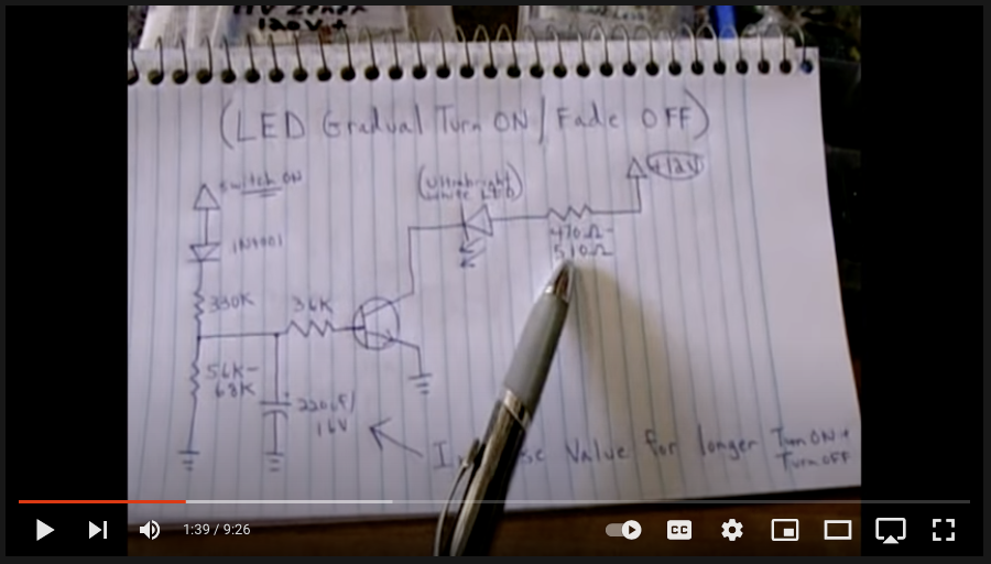

This is something I want to make for an aquarium, but I'm a novice with electronics. Here are my constraints:
  • When power is applied I want LEDs to slowly power up (15-30 minutes) and when power cut to slowly power down (15-30 minutes). Very gradual.
  • Don't want to use a battery, want to use capacitors
  • Want to keep capacitance at "safe to handle" levels. If it becomes a serious shock risk, then I can compromise on power up/down time. 10 minutes at least I'd say but prefer longer.
LED strip I'm using 5 meter strip:
* 4.92 A
* 59 W
* 12 V
I found a YouTube video with instructions online, unfortunately the creator's suggested max amperage is too low.
_screenshot_
Does anyone know how I can update this circuit for my needs? Any help is much appreciated!

An analogue circuit using discrete components similar to those in the video is totally unsuitable for ramp times more than just a few seconds. A microcontroller or some other digital timer would be the preferred tool for the job.
What for?
Why would it? Your LED strip requires just 12V, which is not a shock risk (unless applied through your skin).

Basically, that's a lot of lighting for a long time. Maybe need to revise your aims.
59 watts of lighting, for 30 minutes, if full one, is 59*30*60 = 100KJoules, so given that it's dimming, let's say 50KJ needed.
A conversion system 100% efficient from storage to lighting, and l;et's say as suggested stored at 12volts
Energy in capacitor E = 1/2 C V^2, so capacitor needed about
C = 2*E/(V^2) = 2* 50E3 /(144) = 737 Farads.
Did I goof that up?
So, options include storing at higher voltage and adding something to do the conversion? That v^2 helps there.
Maybe consider a power supply, or battery?
As pointed out above, very long time constants with analog are rather tricky, usually digital is easier.
There are lots of examples out there for led strips controlled by arduino, pis or similar. Digital input LEDs are convenient, easy. Maybe worth a look.

A few thoughts:
  • Dimming (on and off) can be easily done by a microcontroller, e.g. Arduino. Lots of examples out there, code is rather simple. Such a circuit could also be equipped with other sensors for e.g. temperature and environmental light to be used in the decision how much light is required. Or as an additional alarm if something is wrong with the aquarium. Just sone random thoughts of mine, absolutely not required.
  • Analog dimming could be done with e.g. a 555 timer, at less accuracy than using a microcontroller. But that is probably not an issue at all with aquarium lighting. But in order to be reasonably energy efficient, one would use PWM for dimming, not the analog method used in the video. Analog dimming is utterly inefficient and a no-go at the power levels being employed here. An analog circuit with timer and PWM is probably much more complex and definitely less flexible than a microcontroller solution.
  • Using capacitors to supply power for the turn-off phase is out of the question as @Nanren888 has shown. Rechargeable batteries are possible.
    Is there a reason you need to completely turn-off the lights by removing them from mains? In this situation I would go for a permanent power supply (12 V) and control on/off by an input to the microcontroller that does the dimming. Thus you can draw power from mains during the turn-off phase without the need for batteries.
  • If you insist on batteries, a similar calculation as @Nanren888 has made for batteries is as follows:
    59 W max. averaged through dimming over the turn-off phase is ~ 30 W mean power dissipation. Energy required is 30 W × 0.5 h = 15 Wh. Accounting for conversion losses (assuming you will not use a 12 V lead battery), the rated capacity of the battery should be 20 Wh or more. Such a battery is around 20 $ (give or take) plus you will need circuitry to properly charge the battery and protect the battery from over discharging.
  • @Alec_t : LED lighting with 59 W sound a lot. It is equivalent to ~4200 lumen acc. to the specs of the LEDs. According to this site an aquarium needs between 10...40 lumen per liter, depending on the requirements of the plants in the aquarium. 4200 lumen are then good for 420...105 liters. This doesn't sound unreasonable to me.

My original plan was to keep using the same mechanical timer outlet I have. Power on/off was going to start the fade on/off cycle based on charging/discharging the capacitor.
