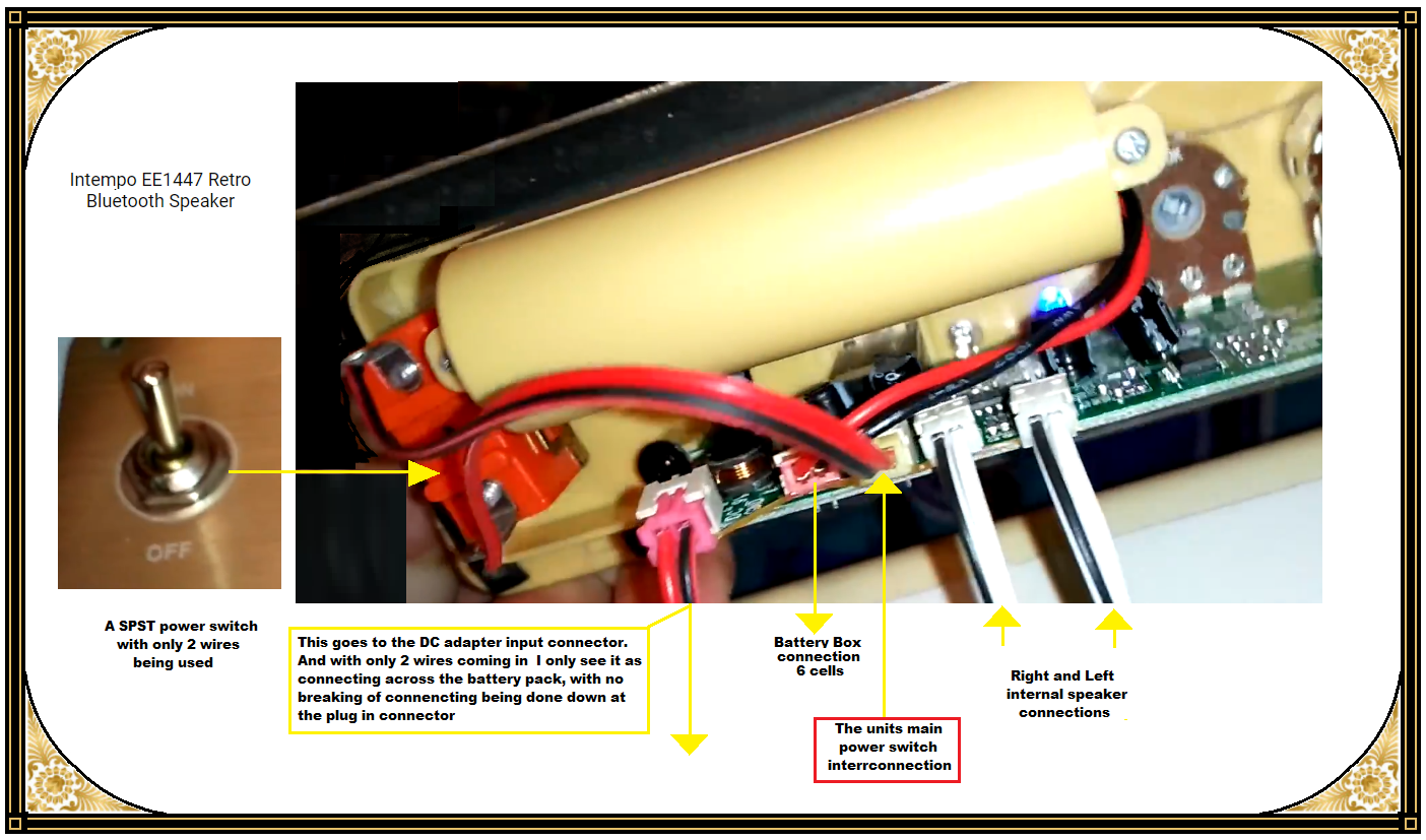

Sir davewheeler . . . . .
One finds absolutely somewhat less than 0% service info / schematics being available on that "Unicorn" unit .
By astute techno observation, one sees that the External DC power comes into the far left 2 pin connector.
The next 2 pin connector is receiving the battery box input.
The final 2 pin connector just routes over to the main power switch.
Lastly are the two irrelevant speaker plugs.
Soooooooooooo . . .if you electrically jumpered across the RED BOXED power switch connector. WITH THE MAIN POWER SWITCH IN ITS OFF POSITION, you just effectively jumpered across the switch and turned the system on, for the duration of that connection being made..
For the second aspect on the noisy audio / or / hummmmmmmmmmming noise . . . . did you use the factory specified or supplied wall wart ?
If not, I would suspect that batteries are being needed in the unit also . . . . with them then sort of acting as a supplemental and additional " filtering" of your external DC input.supply.
You say . . .
I opened it up and had a fiddle with it, got it to work again by sticking an allen key between the battery terminals on the board creating a spark, came straight on. but if you turn it off and on again by the switch it doesn't work again.
I say . . .
You describe the efffects of that main power switch being bad. Leave it in itts off position. Place a jumper wire across it right at its terminals , then confirm that the unit will work with that connection being made 10 out of 10 trys . . . .if so . . . .then replace that dern switch.
Now if you shorted across just below the RED plug which goes direct to the battery box and it has fresh batteries inside, it should spark, but NO logic in the unit coming on and working afterward.
My different photo shows the same wire routing directions and the connectors are probably mechanically keyed so that a connector cannot be plugged in, other than being in its correct position.
MARKED UP WIRING CONNECTIONS BLOWUP . . . .
73's de Edd . . . . .

Many thanks, my liege, for your eloquent response and commendable effort.
Sadly your switch theory holds no water; it was 100% the battery box connection I was shorting, and not the switch.
Illogical, maybe, but as true as the concerto emanating from said unicorn's maw as I write these very words.
Update: I have also had similar success with a perfectly timed jamming in and out of the charger in the back of the device.
Someone has suggested that a momentary dip in power created by either could be compensating for a faulty capacitor.

Sir David Wheeler Esq . . . . .
CONSIDERATIONS . . .
So the main switch is definitely OK and you definitely were shorting the battery connector box out. If that is using Dee size cells . . .vice Cee's . . . and a sum of 6 of them, a dead shorting across them, would have each of them pumping out fom 5-6 amps / 30 w for short durations. BUT the consideration was that you were shutting off power to the main system, alhough, be it in a quite spectacular way.
I see a ver r r r y l o o o o o w probability of ANY service info being forthcoming or being found for that unit at this time..
Now, with you having the main power switch at its on position at all times.
Confirm for me, does 1 jump across, accomplish that desired effect or might it take multiple times to finally end up with the unit coming on, working normal and renaining on until you finally turn it off with the main power switch ?
So lets blaze ahead and see what facts we can develop from a close in photo examination of the boards topside and the bottom foil trace interconnects.
We see that the closest terminal to the corner will be the DC adapter power plug then the battery connector plug and the final power switch plug, with the two internal speaker plugs being of no interest to the problem.
Looking at the foil side of the board we see all negative leads soldered to the ground plane foil, the positive leads float, but they are being within TINY foil islands.
I see the corner plug + connection traveling down the edge of the board until I can see it no longer.
I can not see either of the two other plugs trace paths since they are on the other unviewable foil side of the board.
The most power used in that unit would seen to be with that AUDIO amp IC that you see right beside the speaker plug connectors. Read its part number on its top and pass to us so that we can see if 9 volts is being at its lower parameters, that the unit will work at.
Otherwise, I could see that, being hidden back in the left quadrant of the circuit board, that they are using a switch mode boost converter to hop up the supply voltage .
Your disrupting the power with a short . . . . and its resultant loss of power . . . . could KICK the inoperative converter into operation, as the power comes back.
That being considered, and not shorting the battery connector, instead , how about a more direct approach by using just battery power and then you just turn on the power switch and unplug and plug in the battery connector to blip-blip-blip-blip-blip-blip the power on and off several times to see if the unit jumps into operation just after one of those power plug in / turn on blips.
That replicates your shorting action in turning the unit on and off but the batteries will be happier.
Also you might just try flipping the main power switch on and off in the same manner.
