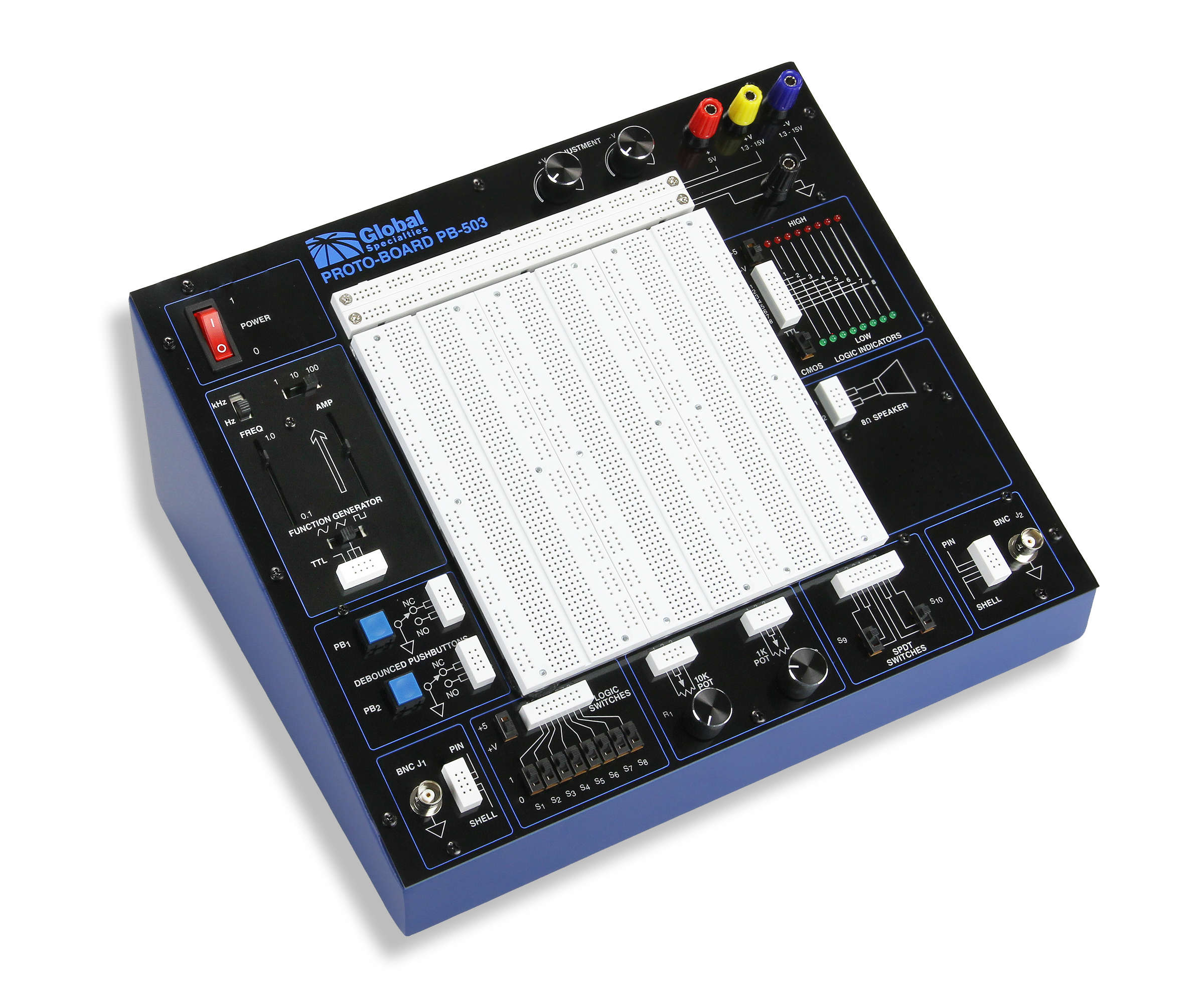

"Tab Electronics Guide to Understanding Electricity and Electronics, 2nd Edition, " by G. Randy Slone. I like it because Slone was the first one to be able to help me understand how a common-emitter transistor amplifier works. I'd read a number of descriptions, but something in his version allowed me to have that "oh, so that's it" break-through moment.
I also managed to find one of these for cheap on eBay:
