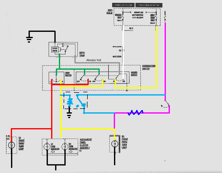

The problem is how to use 1 light bulb for both turn signal and side marker.
I did research a lot of things I can search but not able to find the best solution. I would not like to use too many relay and wires because I don't want to make my car into the processor.

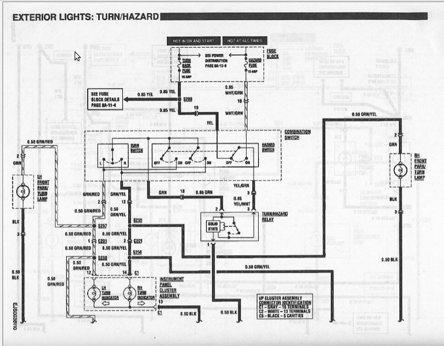

Here is the original diagram... pretty old technology but still fine as new turn signal flasher... (will update in the future)

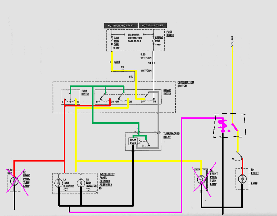

Here is what I am trying to add SPDT relay to turn off Side Marker while duringturn signal or hazard on.
(light blue and pink are added/modded.)
V1 (complex and ignore any errors)
The real problem... Only works if Side Marker enable... so how to Turn Signal during Side marker disabled haha...
V2 (simpler and still ignore any errors... just sketch)
It's impossible to do completely disable the Side Marker during Turn Signal enable. I decide to dim the Side Marker so Turn Signal will light more brighter..
No I don't try or test this in the real life yet...
It would be appreciate if you can give me some points how to do allow both SM and TS to use one bulb...

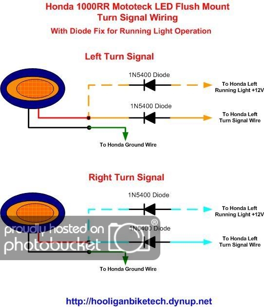

http://www.600rr.net/vb/2111041-post51.html
I also check this diode but it's very unclear how it works to me because I thought the diode only allow the flow in the right direction. I don't understand how it does cancel other power.... maybe that diode is acting like capacitor? (store and release the power supply)
And I know that diode have some flawless design especially heat waste. That's why MOSFET exists.

Quite simply , it won't work.
Circuit shown is a basic steering diode arrangement.
As shown it will work with one input or the other without disrupting any other circuitry BUT when both are active the light will just follow the continuous "on" signal.
What you will have to do is use the blinker enable line to disable the side light signal.
Using a small relay would probably be the easiest.

CMA,
Had a closer look at your post but I cannot see what drives the park/turn in the original.
Not clear exactly what you are trying to do as the original seems to cover it.
Apart from that, the mosfet link is a good idea.
What they are doing there is simply using a P channel which is normally turned on and running normal lights through it. When they want the turn signal to turn the single filament on and off , they simply use the turn signal to the gate of the mosfet to turn it off and hence the bulb flashes.
As they say, P channel is normally in the on state without any gate voltage.
Drawback is the running light has to be on.
To get either of your left or right signals from the indicator to operate the mosfet, then use the other "steering diodes" to isolate the turn signals from eachother.
Diagram below......may need slight mod to match your circuit as I cannot see the whole thing and as many auto wiring systems are earth return.
Hope this helps......not tested
