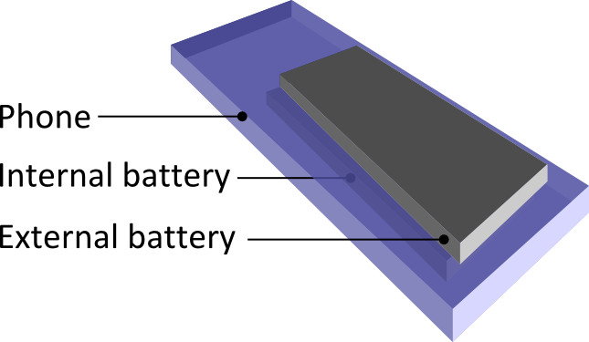

I bought a relatively unpopular phone and therefore there are very few accessories available for it. I'd like to have a battery that can last the entire day on a single charge and so I was wondering whether I can wire in a second battery in parallel to the first. Would they both have to be of the same capacity or is this unnecessary?
I made a schematic which is pretty pointless I guess because it's not a very complicated concept!

If they are the same voltage and both equally charged then there will likely be no problem.
If one is charged and the other one not, high currents can flow between them until the charge levels are similar.
If one gets damaged, the other can discharge into it, damaging it too.
You can't easily protect them using diodes because:
  1. The voltage drop may be significant
  2. They would prevent charging
If you could simply replace the existing battery with a larger one, that would be better.
Another option is a higher capacity battery in a similar form factor.
A third option is to have a DC to DC converter produce 5V from the additional power and connect this to the (presumably) USB charging port. This will manage the power flow into the internal battery and essentially power the phone from your larger battery until it goes flat, then use the internal battery. This is a fairly common arrangement with external power packs.
It would be wise to incorporate voltage sensing on the external battery to prevent it from over-discharging as this will damage the external battery in very short order.
