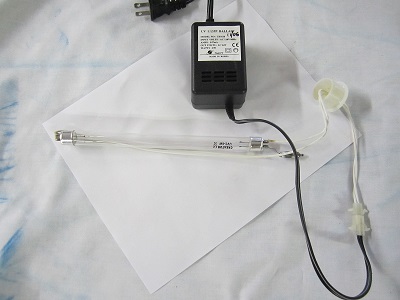

I'm posting three photos:
The shell that the bulb arrangement slides inside:
The UV bulb assembly that slides into the shell:
Closeup of the end of the light assembly:
Two of these photos are of a light assembly that has only been lit a couple of hours, so there's no blackening of the bulb around the filaments. The other photo is of a UV bulb that has seen several months of service but will still light when I shunt the neon? with a 100 ohm power resistor. Yes, it is a fluorescent UV light.

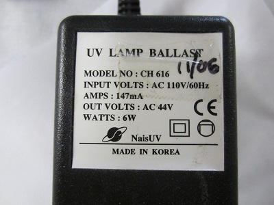

Following are the photos you requested. Something I don't understand is where you say "Following this the starter remains out of circuit and heaters are turned off until the next startup." It seems to me that the starter (the neon bulb) can't really stay out of the circuit since it's in series with both tube heaters. I can see that it would limit the current through the heaters because of the low current that it's able to carry.
The Unit:
The Ballast:

Back to the OP. The UV tube seems to be marked "Creator UVC-6W" which I found and it is rated 6W, 42V, 160mA, 6000hrs life, but no further info about starters or starting conditions.
I see that there are standard encapsulated starters with the GU(10?) type base, which are rated for 6W.
