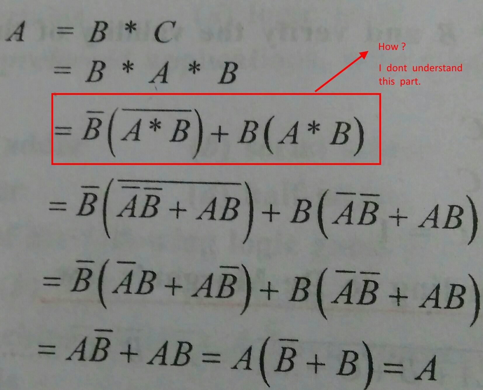

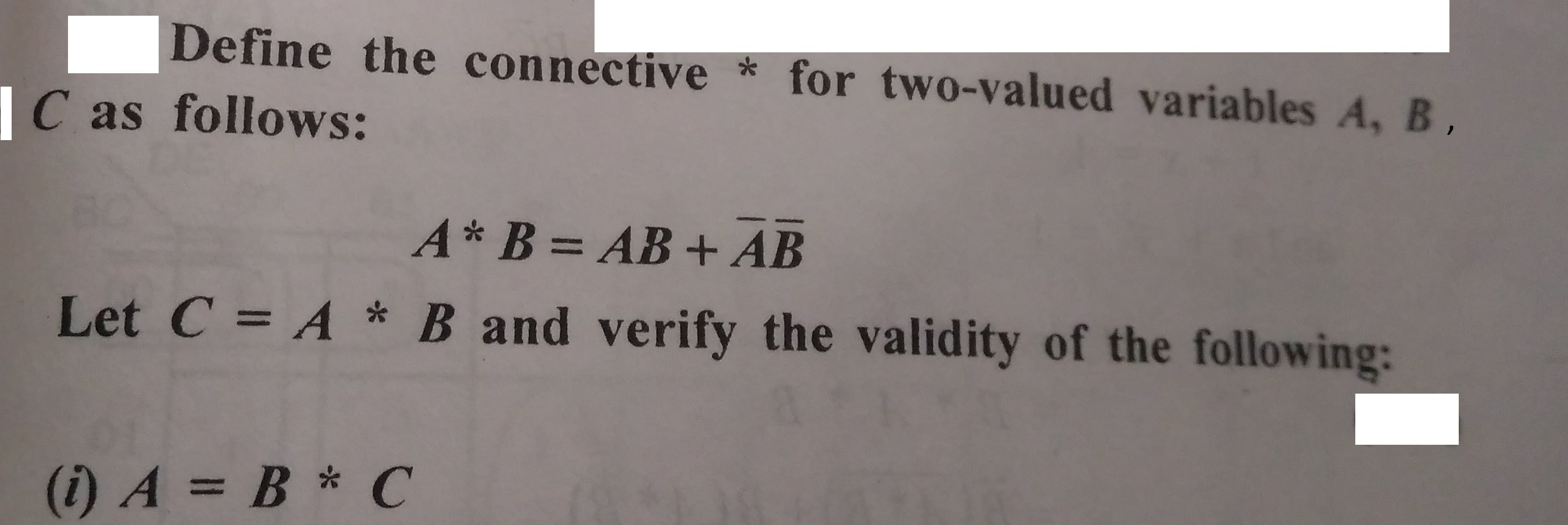

I'm trying to solve this question from my book.
Book has given this solution :
I don't understand that red marked part in the given solution.
Do you think book solution is correct? Could you please explain that red marked part. how did the book arrive to that from the earlier step? I'm stuck right at that part.
Need help.

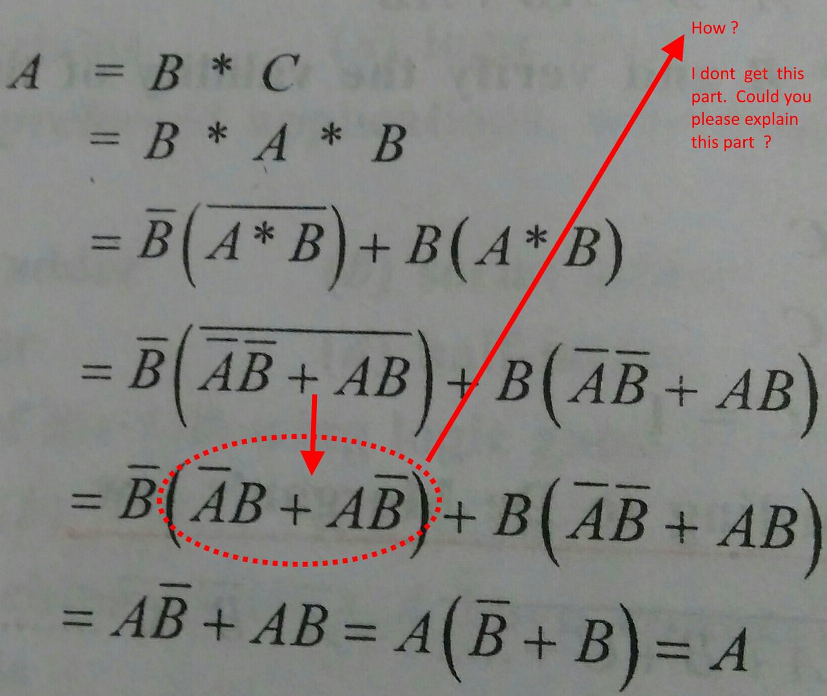

I have understood the above part. ..... book is using "*" definition there.
But I'm stuck in the next step. Is it a law ? which law ? Please see below

The book solution is correct, but the solution method is in error. They made a mistake at the place you cannot understand. The whole expression should be have a bar over it. They must have made another mistake later to get the correct answer. Two wrongs make it right.
Since the "*" means Exclusive OR, why not rewrite the equation as B(AB'+A'B)'+B'(AB'+A'B) and solve that instead?

The book is correct here. It is a simple application of DeMorgan's Theorem.
I don't think so. The "*" in the task description is not the usual AND function. "*" is defined as A*B = AB + /A/B instead.
Assuming that AB means logical AND and "+" means logical OR, then "*" represents an Exclusive NOR.

The original question was how did the author arrive at the circled expression? It was done by multiple application of DeMorgan's Theorem, {When breaking an overbar, the operation enclosed by the overbar changes between AND / OR}.
DeMorgan's theorem is not necessary.
(A'B'+AB)'
1-(A'B'+AB) ; Complement of (A'B'+AB)
(A'B'+A'B+AB'+AB) - (A'B'+AB) ; 1 = (A'B'+A'B+AB'+AB)
A'B+AB'
