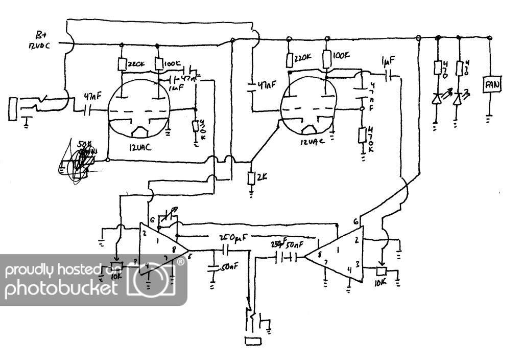

An inefficient way is to put a lot of idle current thru the fet and reduce the source resistor to a very low value. This will flatten the battery quickly though, and need a big heatsink.
I'm interested in this, can you give me more specifics?
Battery life is not an issue. This will be powered off 120VAC wall.
This secondary project is already accounting for the use of efficient heatsinking as well as a fan in the case to dissipate heat.
That is, unless the inefficiency comes at the cost of audio performance.

Using a large current through the mosfet will not give great hifi, since the linearity of the device comes into play. This called a class A power amp and requires a bit of attention to the DC bias to make it work. I can't be bothered with the specifics of this, it is more trouble than it is worth. Just use an LM386 power amp chip after a preamp triode, that's easiest.

After taking a very detailed look at the datasheet, it says pins 1 and 8 can be jumpered with a capacitor together to enhance gain. I, in the diagram, placed a trimming varicap at pins 1 and 8 to allow for adjustable gain. I paralleled it to the right channel to make the effect even.
Does this work?

First, you don't need 2 triodes. If you look at each one, you'll notice you are only using 1 triode in each tube. You can just use i tube, since it is a dual triode. You should not share the capacitor betweens pins 8 and 1. Since thge datasheet specifies about 10uF, you can't use a trimmer. Just use 2 caps. Pin 7 should not be grounded but needs a cap between it and ground.
The caps at the outputs of the LM386 are not right. Sries caps are of no use here. There should be no cap to ground unless you are using the zobel network as suggested. Then you must have a series resistor too. This will stop ultrasonic oscillation.
You should go through and calculate the total voltage gain and see if it meets your requirement. Also, the stereo pot has the hot and wiper swapped.

The use of two tubes is an aesthetic design choice. I don't need the LEDs coupled on to the B rail either.
Is there any purpose to coupling the output at one anode to the grid of the next for two stages of amplification?

There certainly is a purpose. It is to create sufficient gain to amplify small signals. With 2 stages, it allows a volume control to be used toward the lower end of its range, it is how we are used to operating audio equipment. If you would like to use 2 triodes, do this, just make the redundant triode in each tube a second stage. Then you can amplify very small signals.
Random fact: many big Marshall guitar amps only need 0.5mV to reach full power at the output. This gives an idea of the kind of gain in such a thing.
It seems to me you are attempting some challenging design apects for a beginner. That is absolutely fine, but you need to be prepared to build something that does not work at first, then debug it, That is the best way to learn. I appreciate you are trying to make original stuff and that is worthy. It is easiest with this approach to develop a working project into something unique after getting it working first. Then add your own original ideas.
To make a guitar amp from scratch, check out the AX84 project. These things sound great and are basic. They are not kits but there are schematics and different versions on the website. There are helpful people there too to help you get it going. You would have to put in a LOT of effort to come up with something that sounds as good. I made one called an SEL for my son, I just used a different output tube to increase power. You can do endless tweeking too for tayloring your sound, as far as component values are concerned.

If you would rather use valves in the output stage of your headphone amplifier, Google
"class A" "headphone amplifier" valve tube "output transformer"
The first five hits are all interesting.

Regarding the schematic Chris posted earlier (power supply), with two 100uF and one 100nF caps for ripple filtering, can the 100nF be omitted safely?
The 100nF cap is a decoupling cap that should be placed close to the supply side of the plate resistors. There's no good reason to omit it. They're dirt cheap!

You're correct on that count. We don't use nanofarads in the US. In fact my schematics wouldn't display it as such except for the fact that when I enter .1uF Tina automatically converts it to 100nF. How the hell can a supplier be out of stock on a .1uF cap????
Regarding just hanging a bunch of resistors on the output to lower the impedance...
We're quite deep into this thread so I don't feel like searching back though all the posts to find it but I thought I covered that with a spice simulation earlier. Maybe not. In short, no you can't. All that will do is swamp out your available signal. If you were driving a PA with an input impedance of about 1K you could probably drive it with a Cathode Follower or use a JFET Source Follower. Neither would be sufficient to drive a speaker though.

Vacuum Tubes are inherently Hi impedance devices. As Kris explained to you earlier, they can be viewed as an object who's resistance between the Cathode and the Plate is varied by voltage changes between Cathode and the Grid. Since they operate with relatively high voltage and low current they are high impedance devices.
BJT's, are current controlled devices that work with much lower voltages and conversely with higher currents. They are much lower impedance devices than vacuum tubes.
The value of the plate load resistor is related to the conductance of the tube but Kris covered this with you already. I see no point in rehashing it.
As I've stated repeatedly, our tutorial section covers all of this in great detail. Please visit it.
Your amplifier was not intended to be a power amplifier. For this reason a transformer is not an option for you.
