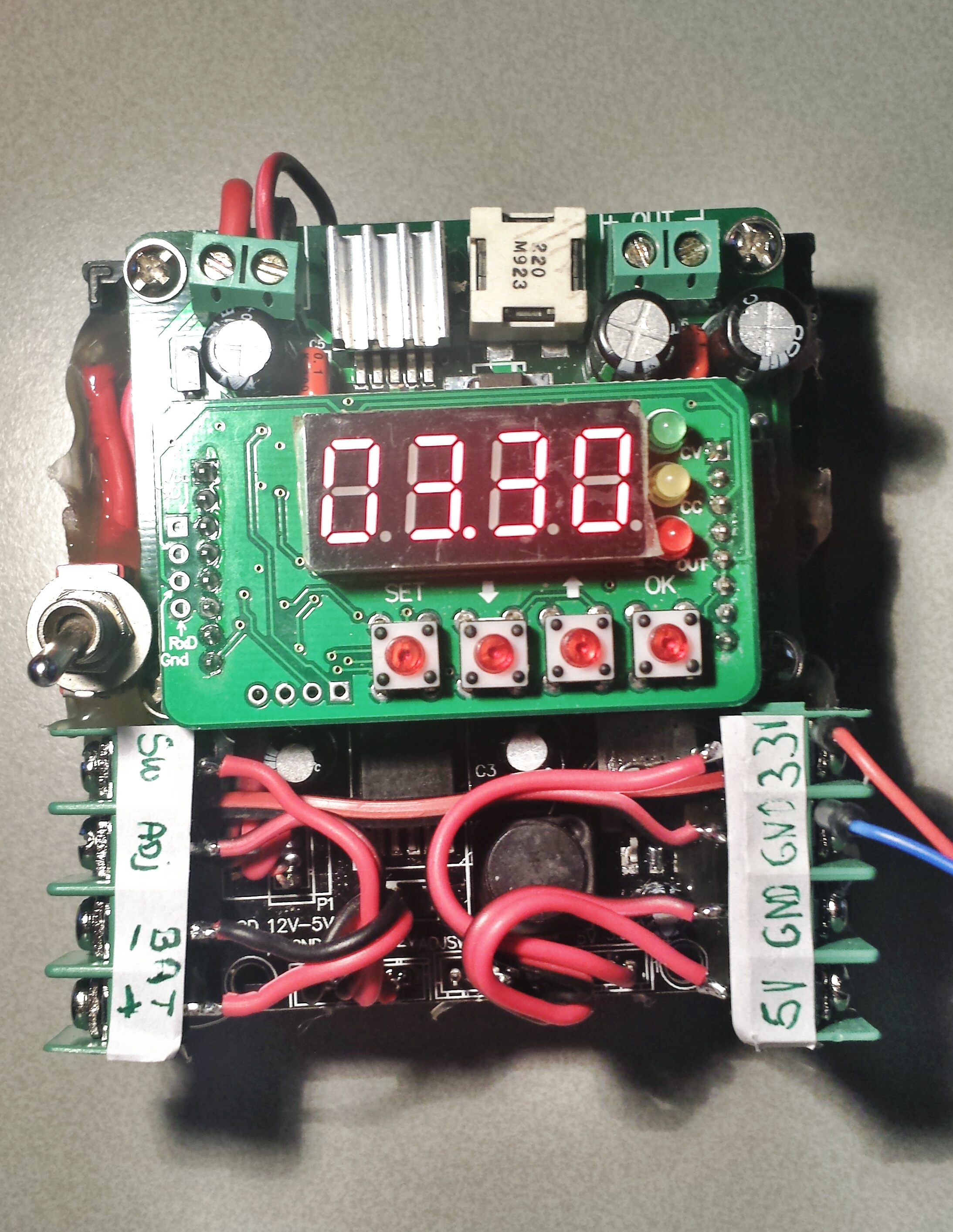

Another alternative is to test the circuit using a power supply capable of current limiting the output. Setting the current limit to (say) 20% more than the expected current will also provide you with a safety net.
Steve, now I understand. Of course. That how I test my leds everytime.
I've build this mobile PSU using 4x 18650 Lipo's in series connected to a digital PSU (ebay) and a fixed 3.3, 5V and 12V buck. With the digital PSU I can control voltage and current. That how I tested the COB leds for their best-max current/heat for this project.
A few connectors, a SPST switch, a 18650 tray and a lot of hot glue and I was done!

LOVE the 2596 module. Great find!
ak
It's great for testing with more (digital) voltage/current control.
It has it's downsides where the voltage often collapses at the higher end as it cannot supply enough current.
The unit has 10 memory locations where you can save/load voltage/current settings.
Als you can monitor power usage.
And it's cheap!
