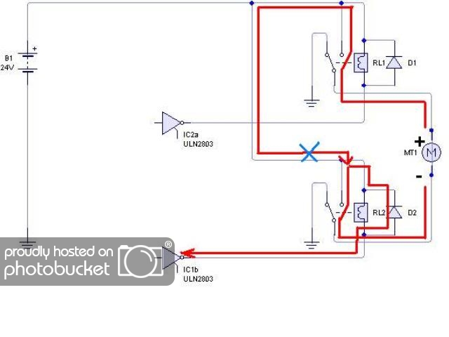

Here's a weird possible cause of damage to ULN2803. This is my theory only and I'm maybe wrong.
I'm thinking that it's possible that "dynamic braking" of DC motor was cause of damage to ULN2803 output pin. DC motor generate dc voltage when rotor was rotating mechanically.
A situation maybe that previously 1st driver was turned on and drive the motor at high rpm. Then 2nd driver was turned on. Both relay contacts 87a and 30 was closed. This therefore the path of negative voltage generated by dc motor because of centrifugal force or mechanical load. Negative voltage find it's way to output pin of ULN2803 NPN transistor and shorting the driver transistor.
Below picture of diagram that you describe. Pls note red line path of negative voltage. Blue X maybe a thin etch that act as resistor or loose connection.

What is HS1 and ES1 in your diagram?
To confirm that negative was cause of damage of ULN2803. Check the resistance of pin11 and pin12 with respect to ground pin of ic. If all the IC have same defect of open pin11. That will confirm negative from dc motor cause of damage. You have to avoid turning on both 2 input of ULN2803.

Thanks Rleo6965,
I was thinking it might be related to the motor temporarily acting as a generator when power was switched off. Does this mean I can put a couple of diodes somewhere? I'm trying to figure it out!
The HS and ES are Home Switch and End Switch. This motor is running an application that turns a threaded bar to move a nut along it. I want it to go back and forward, therefore when the nut hits the ES1 the PC software registers the switch depression, and changes motor direction - that is normally when it goes pop! The same happens when it hits the HS1 but in this case relay 2 is dropped and relay 1 is fired making the threaded bar go positive direction again.
What is the best way to protect my circuit here do you think?
Thanks again so much for your help,
Neil

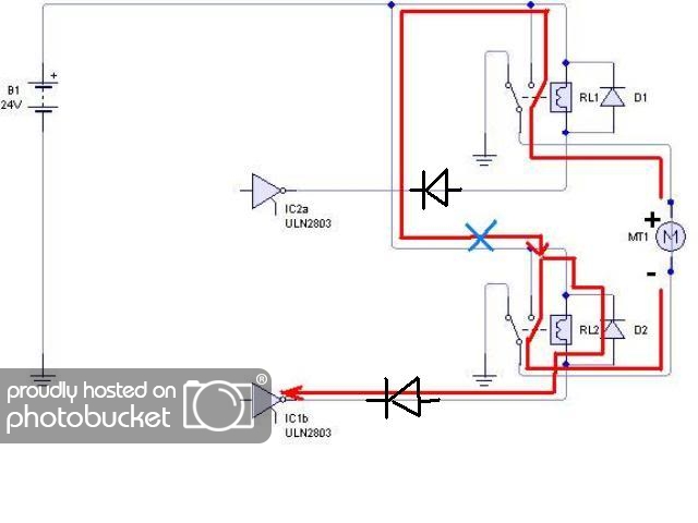

Yes, your right . You need to placed diode as shown in diagram. 1N4001 will do.
Diode will serve as one way switch. ULN2603 output can pull down end of relay but will not pass negative voltage.

Hi Rleo6965,
Well - great news! It works!
So I modified my circuit to include the diodes, but in addition I had a look at the new 24V motors I've been trying. The 12V motors I was using had a small capacitor across it's input pins, but the 24V has one between the input pins and two others, and one between each pin and the shell of the motor.
Additionally, the two input switches I was using were in screened cable to stop any stray interferance from getting in and triggering the switches, but I'd grounded the screening on the structure and I do wonder if this had caused a problem with the motor change - it could be nothing, I don't know, but you know it does bug me that it was working and then stopped working when I went for these 24V motors!
Anyway, thank you very much for your help. I'm really pleased to be running again!
Neil
