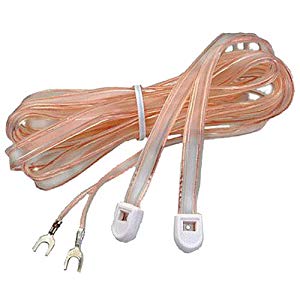

A folded dipole antenna made from 300Ω twin lead similar to the dipole that Duke described how to make can also be purchased cheaply or found with old stereo systems as they're often included with them. They look like this rolled up.
