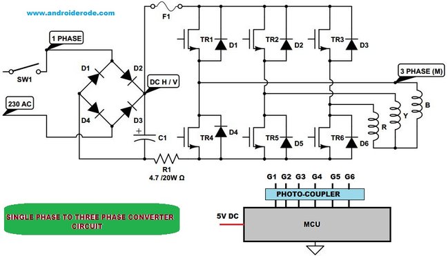

Ok, I found the following schematic. It seems fairly straight-forward.
What I'm not clear on is how to hook up the 230 VAC at the input of the bridge. This schematic appears to assume a single-line 230 volt 1 phase. But what I would like to do is use a standard residence 220 VAC. That comes in as two 110 VAC lines that are of opposite phase with respect to a common neutral. Is that right?
I don't know how to hook that up at the input of the bridge to get the 220 VDC at the output. Would I hook up a 110v line to the switch and the other 110v line to where it says 230 volts on the schematic? And if so then what about the neural line?
I guess what I'm really asking is how to build a 220 VDC power supply using a standard residence electric service. Once I get a suitable 220 VDC power supply the rest of the schematic is pretty simple. Most of the magic will be in the PWM programmed into the MCU. That part I know how to do.

Think you will find the circuit shown would be a much simplified version drawn up for the purpose of understanding basically how it works.
There will be a lot more to it including the uC requirements and programming.
I would not imagine a standard pwm generator programming would be sufficient to duplicate sine waves or the phase timing.

I assumed you are asking for a induction motor VFD?
For N.A. 220/240 you ignore the centre taped neutral and use the L1-L2 legs for 240vac.
The typical induction motor VFD not only creates a 3 phase sine wave but modulates it with PWM for energy content of the 3phase.

I can do that. I can create nice sine waves with something as simple as a 555 timer IC. And then PWM those using an Arduino. So I don't see where there should be a problem producing perfect sine waves. Using three sine wave generators I can phase those three sine waves relative to each other however I want. So I'm not real worried about that end of the circuit. There are probably even better chips to use for generating precise sine waves. I'm from the old school so a 555 IC is the first thing I grab. :D
