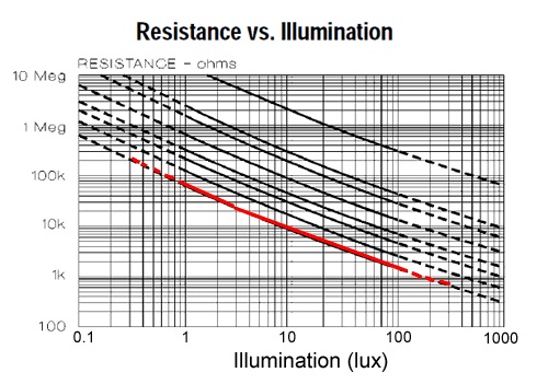

I thought the comparator would be sufficient for the LDR setup
It is. Your comparator works just fine. This thread is discussing how to modulate (switch on and off) the power to conserve coin-cell life. Sorry for the tangent discussion, which I finish below.
What a log amp could do is make it easier to set a threshold level for switching between full daylight and full darkness, somewhere between dusk and dawn for your application over a wide range of light levels. Your current design works fine, but the voltage divider resistors that set the switching threshold were determined by trial-and-error. Not much illumination lee-way is provided with a linear potentiometer in series with the voltage divider, nor does that much accommodate variations among LDR sensitivities if you need to build more than one.
A log-amp would compress the huge range of LDR resistance variations that occur as a function of light intensity into a linear span from which you can easily pick a threshold level from full daylight to pitch black darkness. Of course the span isn't really linear, it's logarithmic, but the effect is to "linearize" the LDR response.
I think it might be worth your effort, from an educational point of view, not for your Halloween decoration, to at least breadboard a simple logarithmic amplifier circuit and "play" with it. You could start with circuits that use just one BJT and one op-amp to do this, but of course simple circuits are extremely sensitive to variations in temperature.
That is critical information as I intend to develop a handful - is there really that much variance in a batch of LDR's these days?
I will look at some inexpensive(?) Log amps today.
As for the mosfet, I didn't realize that two voltages were needed and will nix it from the design. To be honest, it isn't needed since we are not exceeding the current carrying capacity of the pic pin! We can simply switch the circuit on and off with one of the pic gates :D That simplifies things abit, LOL. I will play with an assortment of bjt's later to get a better grasp as well as try to construct a log amp. Thanks for the direction!

LDRs are inexpensive thick-film devices that can have a lot of variation. A bunch from the same lot will probably track fairly close in resistance versus illumination intensity, but I have seen "grab bag" lots that include a lot of different LDRs. It would be nice to have a circuit that would allow you to use any one LDR from a mixed lot and easily adjust the trip point according to the luck of the draw.
Of course this is all just speculation on my part... I haven't played with LDRs in decades, and longer ago than that for log-amp circuits. Unlike most photo-diodes, it's hard to find good specifications (or even good datasheets) for LDRs. See the range of sensitivites from this Adafruit page:
If you stick with "identical" LDRs from the same manufacturer your original Halloween toy should work just fine. I'm just trying to show you another path. Stay away from the Dark Side, even though they have cookies. Well, maybe small steps to the dark side are okay, but the important thing is to have FUN!.:rolleyes:
