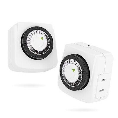

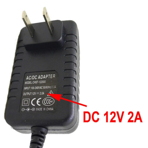

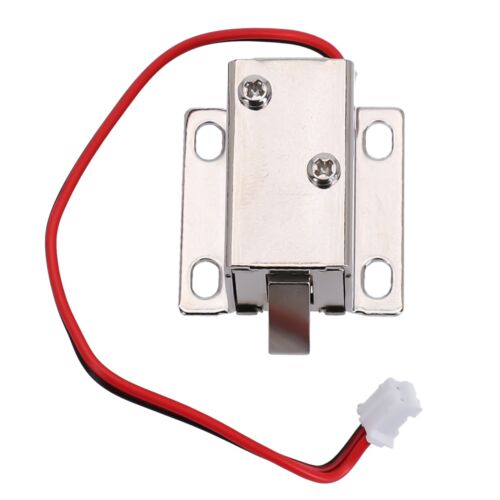

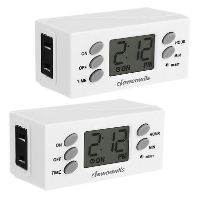

Think about this.
A spring-loaded lid that pops open when a latch is retracted.
A small solenoid connected to the latch.
A small wall-wart type power supply to power the solenoid.
A lamp timer.
A 3 am, the timer powers the wall-wart, which powers the solenoid, which retracts the latch. For a second bowl, build a 100% duplicate with the timer set to a different time.
The lamp timer and wall-wart are available at Walmart, but cheaper on ebay. A suitable solenoid should be on ebay somewhere.
No programming, no electronic components, all of the wiring is wire strippers and wire nuts. You probably can scrounge the wall warts from friends with old digital cameras, answering machines, phones (before everything went USB-C), etc.

Excellent. One question -- the spring loaded lid and latch...is that something I can procure or do I need to build it from scratch?
