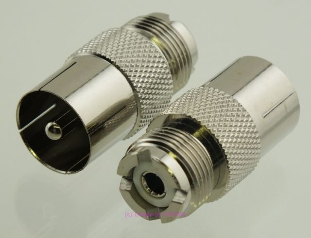

Hi Steve.
I have PL259 plugs unthreaded, but springy friction contacts to make the connection. They are for fast connect/disconnect in equipment tests or manufacturing/calibration, where you have to plug/unplug hundreds of times during a production work day doing only push-in pull-out.
I suppose your BNC are also made that way for quick connection without need to fasten/twist in production environments.upload_2019-5-18_19-33-57.jpeg
There is 'F' type too.
those are belling-lee to SO239
Belling-lee are 75 Ohm and mostly used for TV
