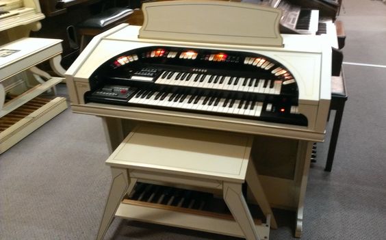

Years ago I bought a Conn organ off the showroom floor, probably paying waaay more than it was worth. I think it was a Conn Model 552 Theatrette Organ. See images below. I installed it in our smallish living room and (probably) proceeded to annoy the neighbors as well as my family with my feeble efforts to learn how to play it (loudly).
images
This was a vacuum-tube based organ, consisting of several groups of twelve independent oscillators making up the chromatic musical scale. Various wave-shaping circuits controlled the timbre or "voices" of the organ. The two keyboards were a maze of wiring and tiny neon lamps that directed notes from the wave-form oscillators to various wave-shaping circuits. The organ even had a rotating Leslie speaker as well as a tremelo circuit. Lots of knobs and levers and one-and-a-half octave foot pedals (including a volume control), which may have been excessive "window dressing" considering its intended use inside a home.
But, what the hey, back then I was raking in the big bux as an electrical engineer working on highly classified "stuff" for the guv'mint, so I could afford the indulgence. I never did learn how to play the organ, or any other musical instrument for that matter, although I continued to try to learn with MIDI synths and MIDI piano keyboards until finally giving it all up. I may try again later this year with the guitars the grandchildren left behind. They were sensible enough to acquire (somehow) tube-type guitar amps for their garage band, before disbanding and going their separate ways sometime in the last century... leaving the amps and stomp boxes behind for me to ponder over.
I agree one hundred per-cent with your distinction between production and reproduction of audio. Reproduction fidelity is a "given" in the professional music industry today, although I haven't kept up with the "latest and greatest" loudspeaker and enclosure developments. I doubt I ever had "Golden Ears," but surely today they are definitely rusted and otherwise corroded. I now "enjoy" almost anything loud and boomy, pretty much as I did in my youth. Wife bought a portable Bluetooth JBL stereo speaker the last time we were in the Sprint store. I like this a LOT, especially after I bought a Bluetooth USB dongle for my H-P Pavilion g6 laptop. I have a lot of tunes ripped years ago from CDs. I've kept the CDs too, but prefer the convenience of having content readily accessible on my hard disk drive or on the shared network storage drive. One of these days, "real soon now," I will revive my turntable and try to save some tracks from my vinyl record collection. I think most of this stuff is now available for download in "re-mastered" form on my Amazon unlimited music subscription, so it may be a total waste of time trying to recover anything from vinyl records
